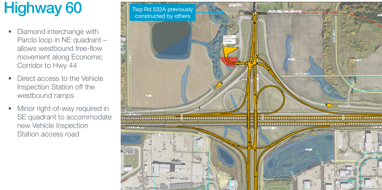

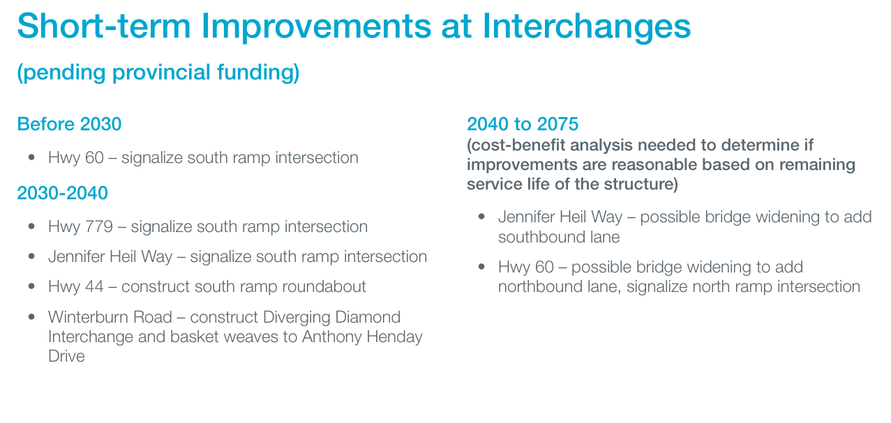

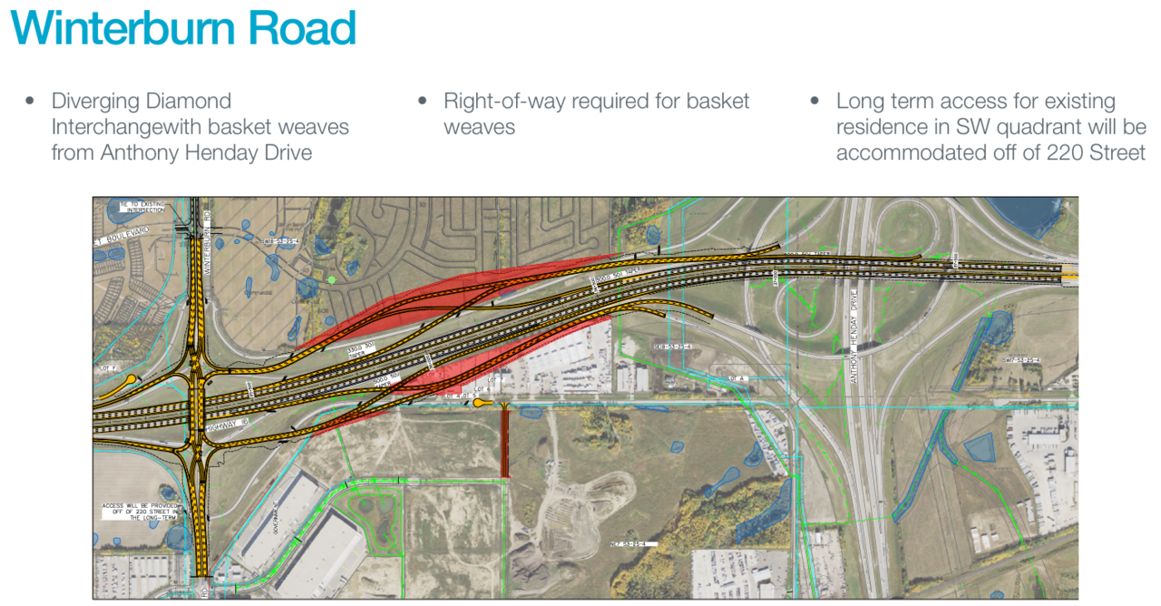

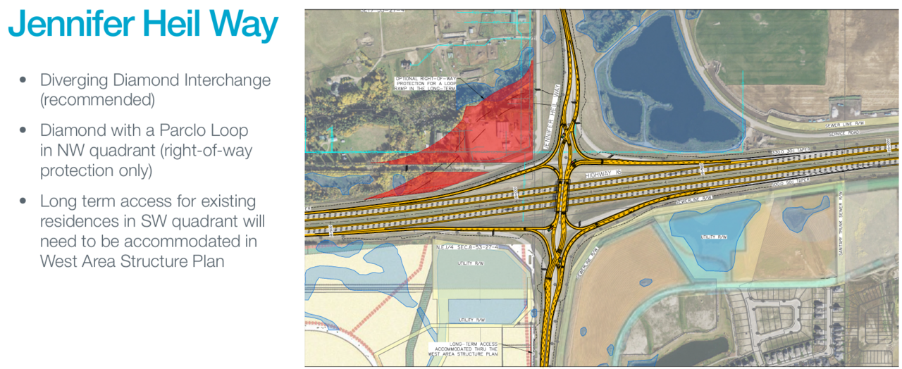

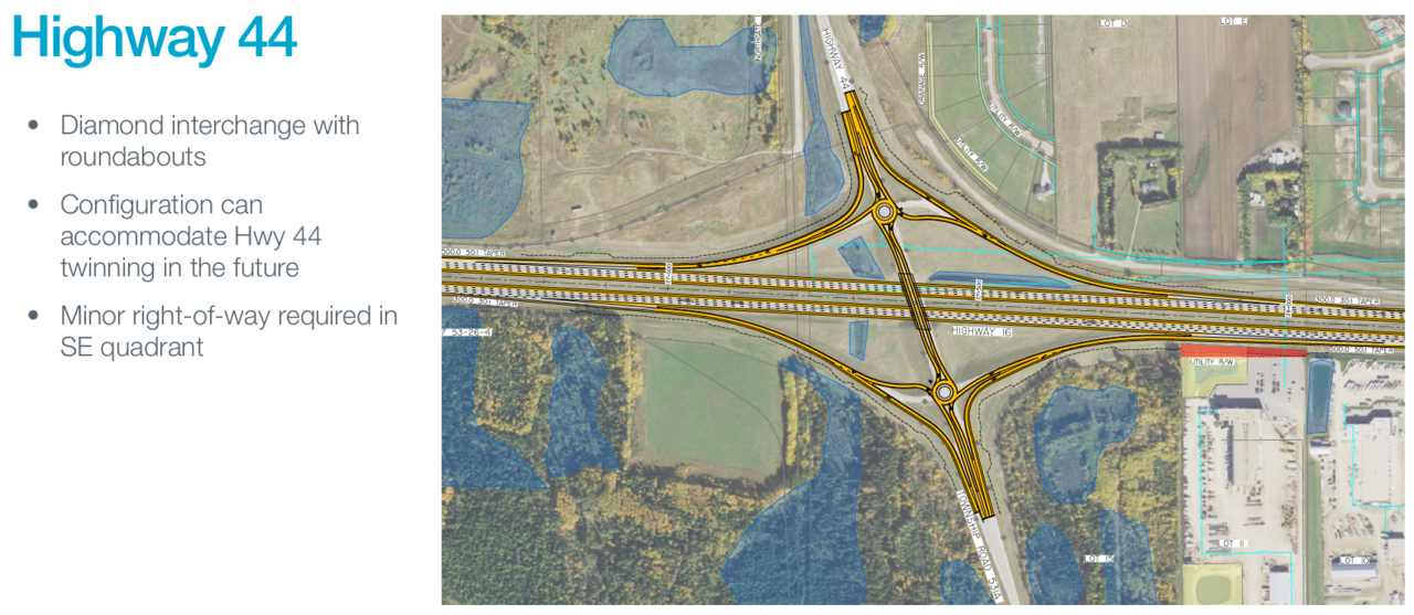

After driving to/from Jasper and seeing how much traffic has boomed on Yellowhead Trail from Edmonton to Stony Plain, it made me wonder if there are plans to upgrade this stretch of the freeway. Turns out the province just finished a planning study last year, and holy mother of diverging diamond interchanges! Here are some images from an open house for the interchange and freeway upgrades, including a much needed basket weave at Winterburn Road.
1751665324257.png1751665382601.png1751665446982.png1751665469319.png1751665604814.png1751665766683.png
The presentation doesn't establish clear construction timelines, but does say this:
All in all, I hope the widening of the freeway to 3 lanes in each direction happens before 2030, and all necessary interchange upgrades (particularly at Winterburn Rd) are done by 2035.

Do I see 4 lanes even up to the Henday interchange? I'm honestly shocked we're getting any freeway upgrades, but probably largely the businesses around Acheson followed by commuters from Parkland County lobbying for this work.

They needed to start on the Winterburn interchange five years ago. YHT WB before Winterburn Rd is already at a stand still daily from 4-6 PM due to the two consecutive Henday off ramp merge lanes that are only 500m apart onto a two lane stretch. The high frequency of heavy truck traffic coming off the Henday NB off ramp particularly struggle hard to accelerate up to merging speed which really bogs things down.
Only going to get much worse as Hawks Ridge, Kinglet and Pintail Landing are all rapidly developing housing. I bet by 2035 when there will be 12,000 more people living there, the vast majority of which will be utilizing the Yellowhead and Henday to commute.
