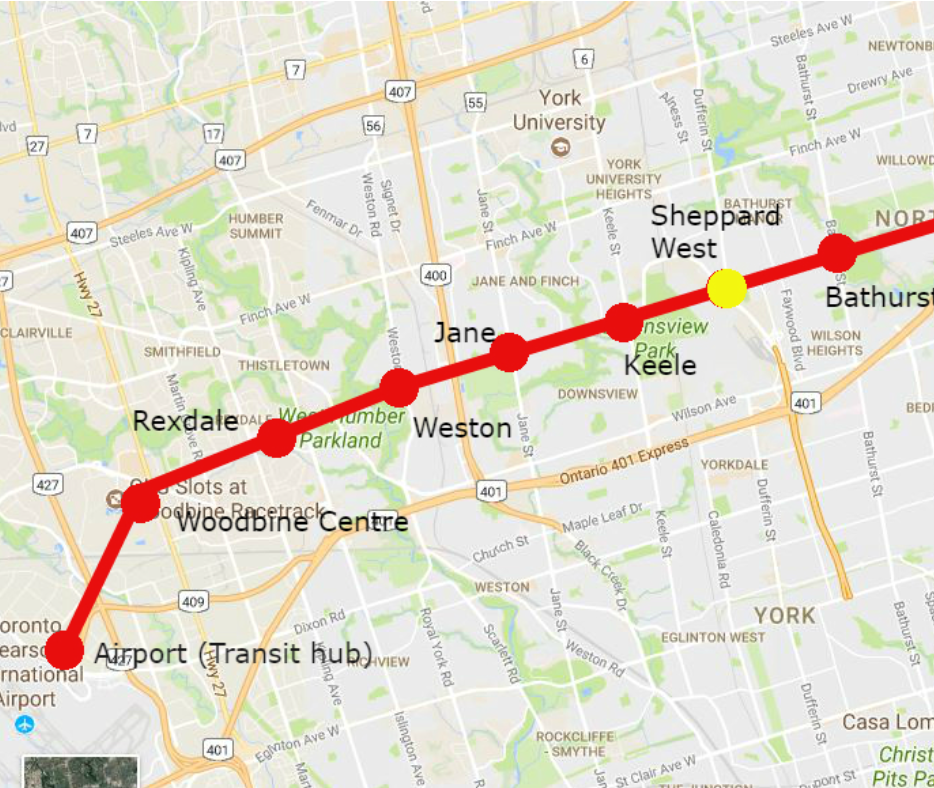

I suggest it continue to the airport. I put this on my blog
You could have Islington and Kipling instead of Rexdale, but the idea is an express subway line across Toronto to relieve the 401.

I suggest it continue to the airport. I put this on my blogView attachment 668038
Doesn’t look very express to me, and Finch W is just to the north. Cutting SW to Wilson seems the more sensible routing even if it misses Woodbine, since there are at least two malls en route which could be developed as stations/TOD
The stations are at least a mile apart. That's a long distance in subway terms.
I wouldn't be opposed to running along Wilson, but I do think Woodbine mall and casino should be on a rapid transit line.
My main thinking is that we need a subway to take some of the traffic off of the 401. Going from Scarborough Civic Centre to the airport could really help. Even extending the line west a stop to the west of the airport would serve a lot of employment.
