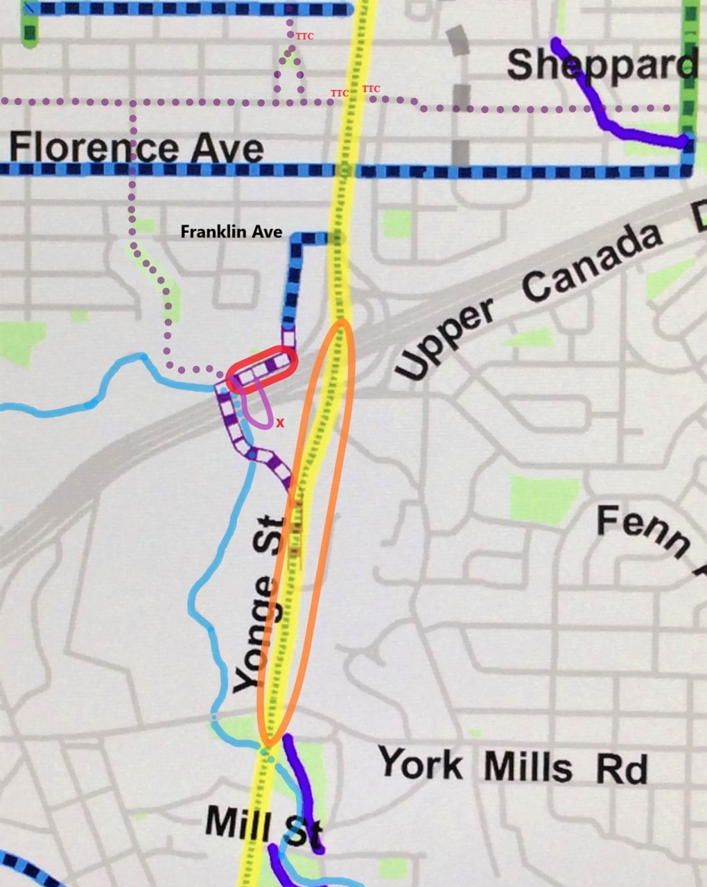

Path shown in purple-line north-west of Yonge-401 interchange:
https://urbantoronto.ca/forum/threa...xtension-proposed.20503/page-137#post-1317984
In the YouTube video by CycleToronto posted by W.K.Lis shows how to get there from 1:20 to 2:00
https://urbantoronto.ca/forum/threa...xtension-proposed.20503/page-136#post-1317811

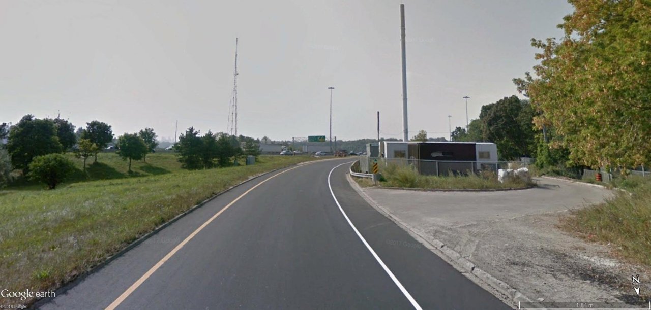

On the southbound Yonge to westbound 401 on-ramp, there's a gate to a Service Road (lead to service emergency TTC exit at bottom of valley) Gate usually locked on weekend and if open Monday to Friday usually MTO/contractor nearby,....
Going through gate and travelling along paved Service Road for about 150m:
Until you reach a dirt trail that goes under bridge structure near valley ridge
That leads to this separate grade crossing of 401,...
Note: the other side requires a bit of hiking to get to Radio Tower which has paved Service Road and then Golf Course driveway leading to William Carson Crescent,....

There's NO Tresspassing signage posted throughout the area around Hoggs Hollow Bridges,... MTO and their contractors, might occasionally have someone there Monday to Friday,.... hmmm,...

From the north (on weekend, the Gate is locked but most can roll under), I would suggest going:
- west along Franklin Ave
- then south along Stuart Greenbelt (marked in dotted purple line); the tributary/river is buried here with old (1940's?) asphalt trail on top that has disintegrated!
- just before you reach West Don River turn left (east) - follow well worn walking/hiking trail
- when you come across the fencing for the Service Road - turn right (south) and go under Hogg Hollow Bridges
- Here, on map - you're following the Solid Purple U-Shape path just east of the river
- follow the dog paw prints south and you'll figure how to go around the fence without climbing! Dogs are smart!
- at the end of the Service Road - bottom of Valley - you'll find this bunker-type TTC emergency exit/substation built into the side of the hill (red-X on map)
- near the top of that same Service Road at valley ridge is the separate grade crossing of 401 just under bridge deck.
