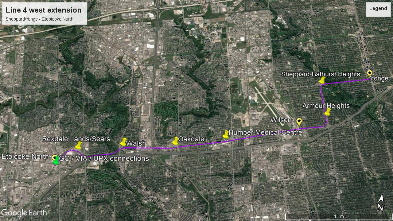

I like your thoughts about connecting Line 4 to Wilson station:). Having an interchange at Wilson makes a lot of sense for a few ways. First of all construction would be less disruptive to Line 1 at Wilson since it has lower passenger numbers than Shepppard West and also Wilson station which has been operating for 40 years without a major renovation is coming due to major renovations and easier access elevator upgrades before 2025. So an upgrade to the existing Wilson Station and brand new infrastructure to create a new underground Line 4 platform level. The other is that Wilson is located in close proximity to a whole bunch of new condos along Wilson and Allen Road. it is also near the Downsview Bombardier lands which I heard that are planning to be sold to developers.
A Line 4 western subway extension from Sheppard-Yonge would serve the relatively dense corridor of Wilson Avenue which is mainly mid rise with several proposals for growth espically in the area surrounding Wilson station. Their is more existing and possible density on Wilson than Sheppard in this area. After Allen Road, Sheppard W. unlike Sheppard E. becomes mostly low rise commercial and residential and Sheppard ends unceremoniously at Weston Road. while Wilson passes through the heart of Downsview, Humber Regional Hospital, the MTO complex, a Seneca campus and several retail centres and mid rise condos. Than Wilson becomes Walsh Avenue before becoming Albion Road.
The would pass under Sheppard Avenue W. until Bathurst where it would turn and run under Bathurst until Wilson where it would curve under into a Wilson Road alignment in the Armour Heights neighbourhood, the line would run underground along Wilson beneath the Allen Rd and connect with Wilson Station on Line 1. It would continue under Wilson, passing Dufferin, the Barrie GO line, Keele, Jane, hwy 400, and Weston Road.
Then the Line 4 alignment could emerge from its tunnel just after Weston and Walsh and cross the Humber river by bridge. then pass by at-grade where Pine Point Park is, then re-enter a tunnel to cross Islington and enter the former Sears warehouse lands in an underground alignment south of Rexdale Blvd. where a mixed-use development is currently proposed. Then the alignment could proceed underground or elevated towards Etobicoke North GO Station where a connection could be made to GO RER as well as possible VIA and UPX service.
This Line 4 extension could be fully designed while being completed in phases like the way Line 2 was completed in phases from 1966 until 1980 when Kipling and Kennedy opened.
The former Sears warehouse lands have huge potential for redevelopment into mid to high density residential and commercial. This site could be well served by a Line 4 west extension.
