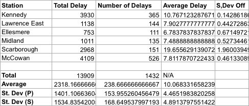

You can state that the SRT has the "best on-time" performance of any Toronto RT line without looking at statistics and I won't believe you. Here are the delay times for each subway line and the number of delays for each subway station sorted by line:

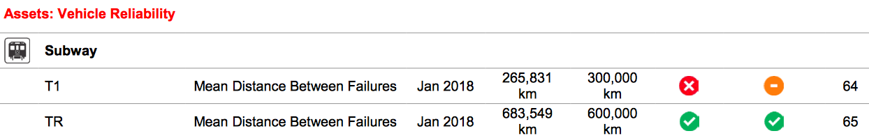

The most recent CEO's report confirms these numbers
https://www.ttc.ca/About_the_TTC/Co...cutive_Officer's_Report_March_2018_Update.pdf

The original numbers were taken from the Open Toronto, and include delays between 2014-2017(1st quarter). First off, we notice that the average number of delays per station is lowest for the Sheppard Subway, not the SRT. Second, we also notice that the average delay time per station is actually HIGHEST for the SRT by a margin of about 600 delay minutes per station. This is followed by the Bloor Danforth Line, The YUS line, and the Sheppard Line. Therefore, this statement that "The SRT has the best on-time performance of any Toronto RT line" is a flat-out lie.
Second, you cannot compare the SRT's delay numbers with other lines and say that the technology runs better as a result. If one hasn't noticed, Lines 1 and 2 are about 5* as long as the SRT, making it more prone to significant knock-on effects. It should also be mentioned that the infrastructure on Lines 1 and 2 are about twice the age of the SRT, making the infrastructure a good indicator of delays, not the technology itself. The CEO's report indicates that the TR trains are having mean distances between failures of:

Which is quite impressive. The SRT trains don't have values which is unfortunate, but it clearly shows high reliability in the subway cars (they vary month to month due to weather conditions and human interaction with the cars. Just in January, the mean distance between failures for the TR cars was around 1.2 Million km).
