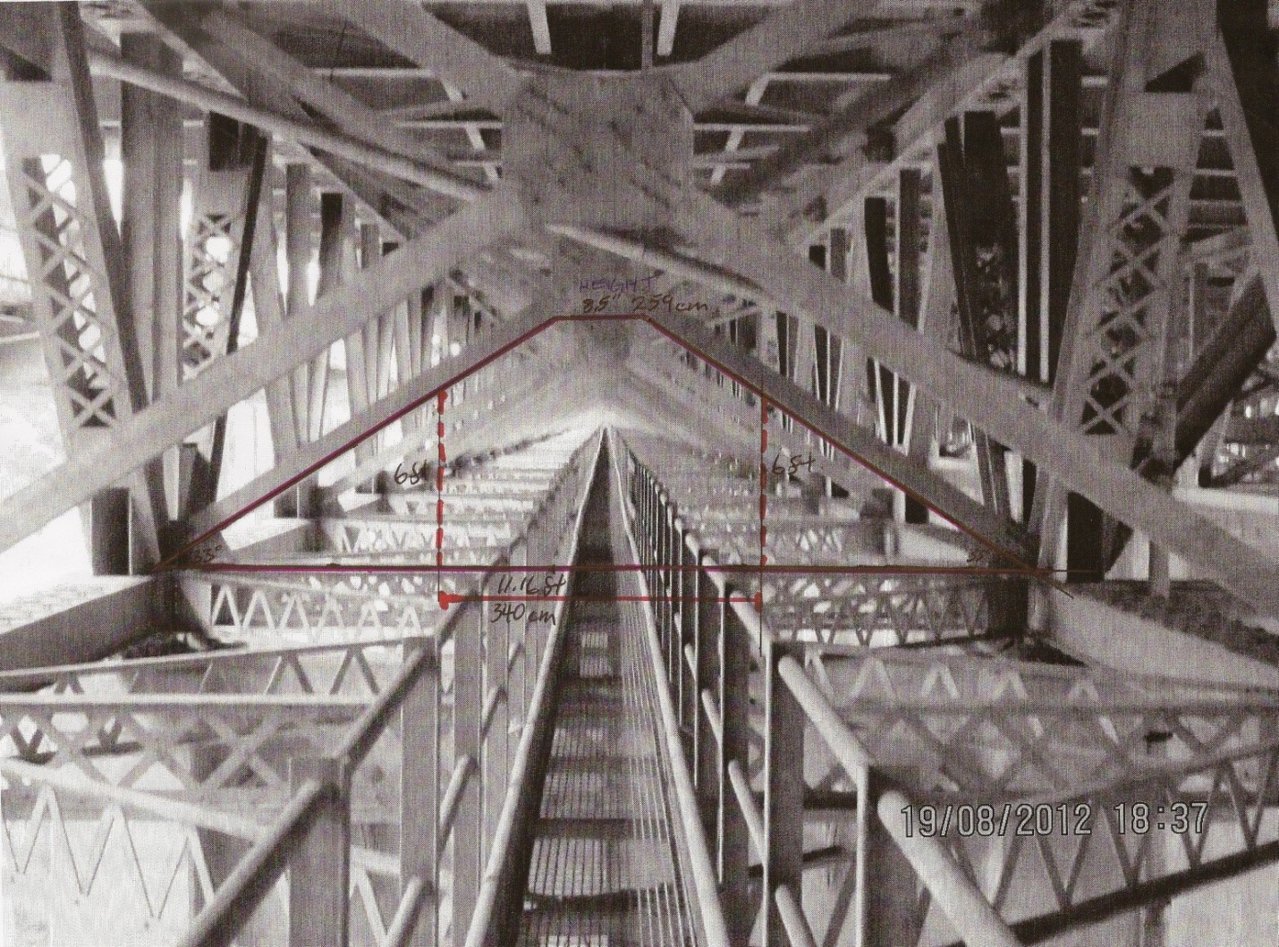

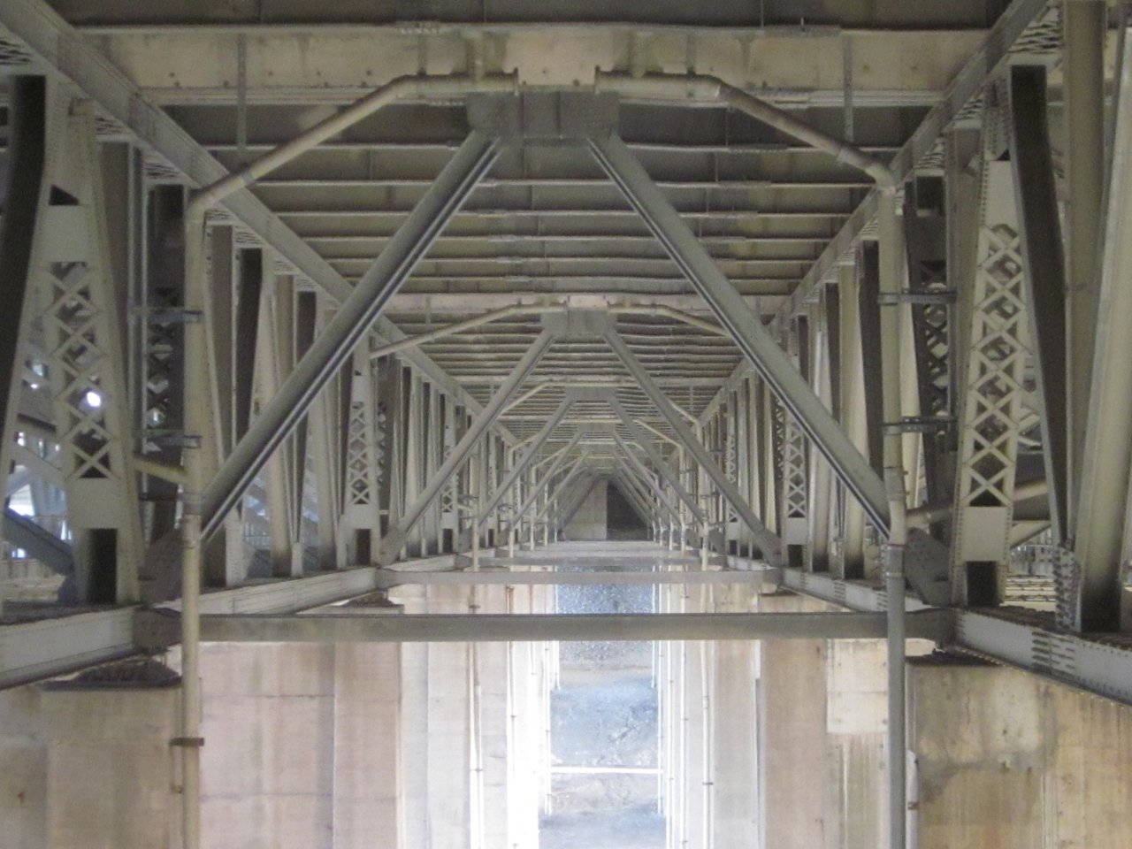

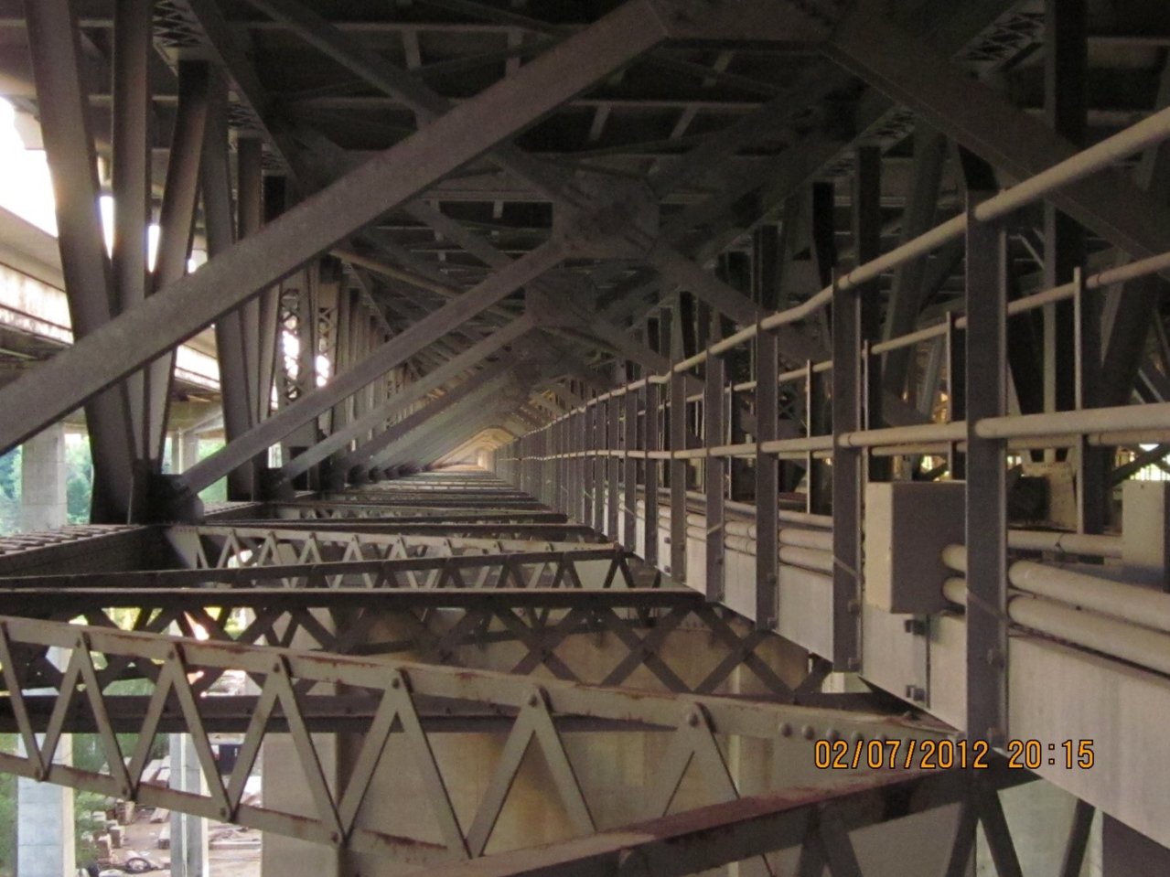

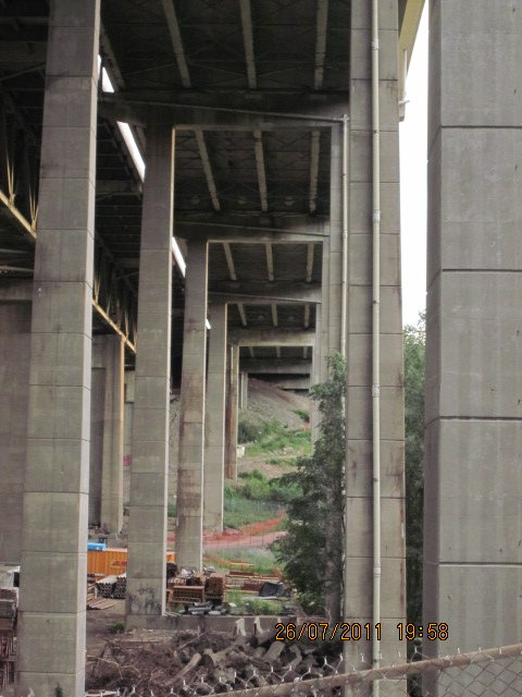

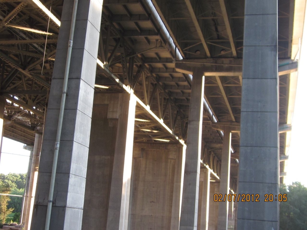

Highway 401 Hogg Hollow Bridges are actually made up of 4 parallel bridges:
- The two in the middle are Double Truss Bridges - upper deck for roadway and lower deck for structural support and currently under-utilized (somewhat similar to Bloor Viaduct is Double Truss with Arc support):
--- one built in 1929 (@ $1million when bread was 5cents a loaf, factor in today's $5 a loaf and I guess you get $100million per bridge!) as Yonge Blvd Viaduct as detour to avoid steep valley hills on Yonge Street - now host 401 westbound express lanes
--- the other double truss built in 1952 for MacDonald-Cartier Freeway - now host 401 eastbound express lanes
You would be right in that,.... these lower deck are NOT weight bearing - they can barely support catwalk - won't support subways! Really just rust flavoured jello!
- The two outer bridges are Girder bridges (like elevated Gardiner Express) built in mid-1960s as MacDonald-Cartier Freeway converted to today's Higway 401 Express-Collector system:
These 2 Girder bridges can host a subway line hanging from it's load bearing deck similar to this:
The new large single deck built between the two Double Truss Bridges (westbound & eastbound express) can also host a subway line hanging from it's load bearing upper deck (space is about 20 feet high and 25 feet wide):
Thus,.... no Hellium or Hot Air required!
