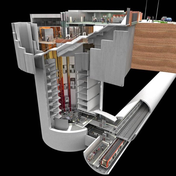

Barcelona has come up with a potentially cheap method of building stations.
The only way to get to the track level is by elevator. The engineers claim that the elevators are fast enough to get passengers to track level without delay, but I’m justifiable sceptical. However the line is already under construction, so we won’t have to wait too much longer to see how it performs in the real world. If this works out for Madrid, then I’d have to problem importing in into Toronto.
They also use several other innovate cost saving measures that are outlined in the article, including methods that eliminate the need for costly emergency passageways and exits.
This might be the most exciting development in subway-building technology since the boring machine!
When I lived in NYC, at my local station (168th st), if you needed to take the (1) train, the only way to get down was via four elevators. Inevitably, many would be out of service. It was terrible.
I would also be skeptical.
http://www.cat-bus.com/2017/10/barcelonas-line-9-inspiring-montreals-pink-line/
It already exist - Av. Tibidabo station on L7 in Barcelona - it worked fine enough when I was there, but it is a terminus station on a not particularly heavily used line.
Cheap for construction - but I wonder what the ongoing costs of a station like that will be. I can't imagine that it would be so much cheaper to construct as to offset the additional electrical and maintenance costs over much of a time period.
Dan
Toronto, Ont.
If it replace multiple escalators, perhaps?
Dan
Toronto, Ont.
It also eliminates the need for separate elevators for AODA compliance. Everyone, disabled or not, would use the same elevators to reach platform level.
However I'll still admit that the Barcelona setup might still be more expensive to operate than traditional metro stops. But, I suspect the construction cost savings provided by this method are large enough that it would take several decades, if not 100+ years, for the increased operational costs to offset the construction savings. And let's not forget that the economic benefit of building stations that otherwise would not have been built will almost certainly offset the additional operational costs of the Barcelona design.

I'd love to hear how this works from a firecode - evacuation capacity standpoint. I assume their are also stairs, but given great depth, how fast can people exit? Also is there a secondary stair well lest the principal path be obstructed?
Otherwise, I have an open mind on this method.
