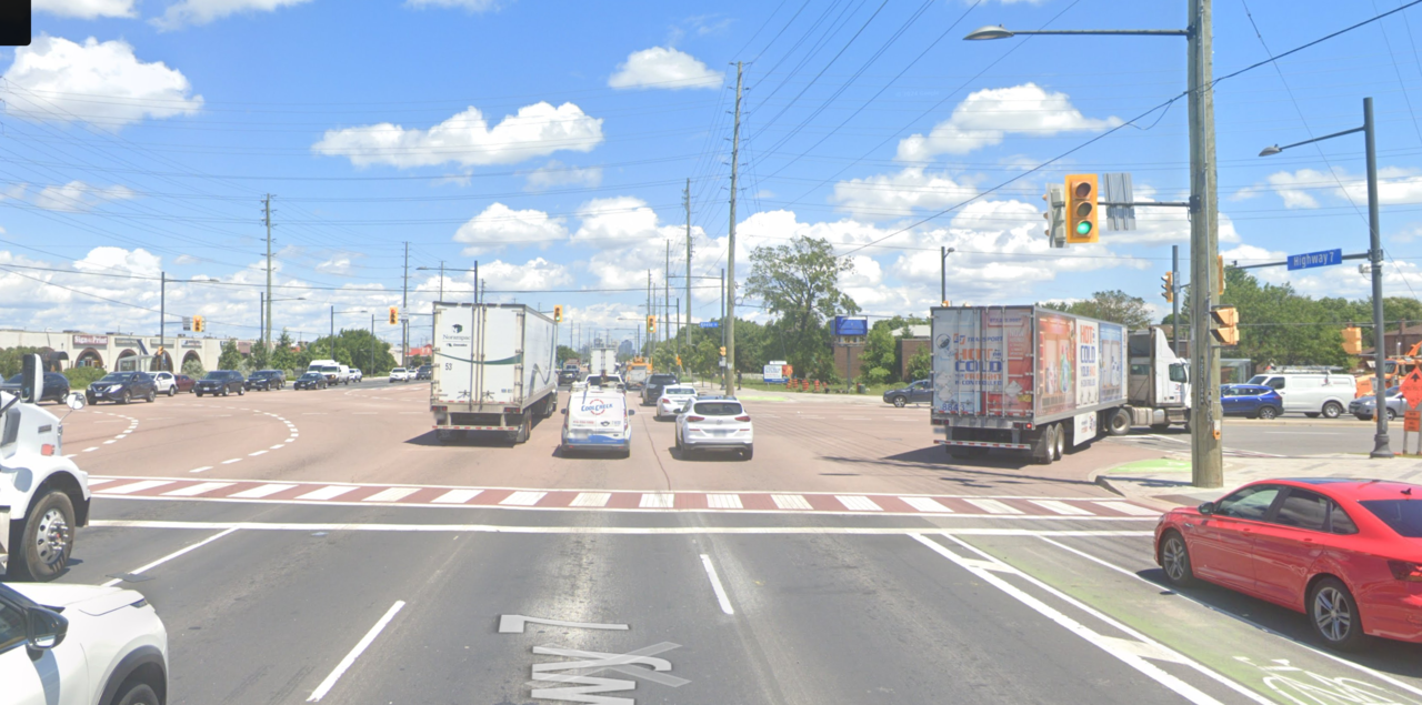

It really does seem to me the way this city implemented Leading Pedestrian Intervals is a joke:
It's just meant to slow everyone down unnecessarily.

Ottawa did it right. Toronto instead penalizes all through-traffic (be it car, bus, or bike), as if the desire were to slow the city down as much as possible.
Three seconds at almost every traffic signal really adds up, and can be counterproductive itself.
It's probably because there is no money to replace the traffic lights with ones that have a straight arrow in addition to a regular green signal. What Toronto implemented is presumably just a software change that costs little to implement.

"Unnecessary idling" is a red herring that is only really used as an argument by people who want to shoehorn car traffic into places it doesn't belong. In reality the negligible impact of longer idling times for internal-combustion vehicles without stop/start technology is generally offset by reductions in trip attractiveness (fewer trips). I don't recommend using idling as an argument.
What is an issue, however, is the lack of credibility. Showing a red light while there's no actual conflict is a surefire way to normalize signal non-compliance. Which is a huge safety issue since signals only work if people obey them. On top of vehicles heading straight, current LPI implementations make the Flashing Don't Walk countdown meaningless since you can often start crossing after the countdown has ended and still make it all the way across the street before traffic gets a green.
The City's LPI approach is deeply flawed as Jackson has done an excellent job of documenting. There are many ways of minimizing unnecessary impacts of LPI, such as arranging phases such that the LPI occurs during time that the signal needs to be red regardless, using dedicated signal heads to hold back right turns while allowing thru movements, or using leading thru intervals, the latter two of which are done in Ottawa, but are virtually unheard of in Toronto.
