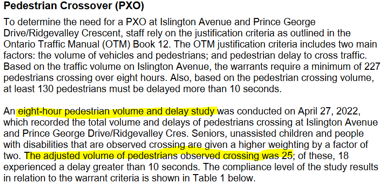

The main rationale is that there's otherwise no safe way to cross the street to access the bus stops (it was previously 825 metres between pedestrian crossings, which is extremely long).

The report is here:
https://www.toronto.ca/legdocs/mmis/2023/ey/bgrd/backgroundfile-234440.pdf
Thanks for digging up the report on this one.
Make no mistake the distance between pedestrian crossings is long here, but at the same time this is also a bus stop that's virtually never used. I mean frankly i'd even go as far as saying it's borderline useless due to the very light use and the city's own observations even alludes to it:

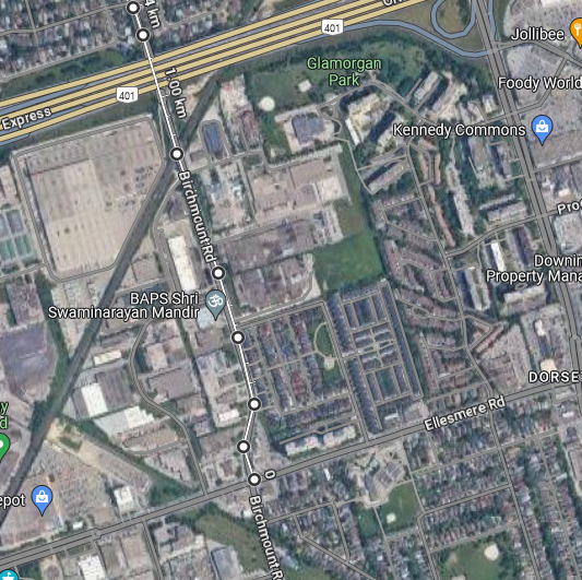

So if the city is going to use their rational here for installing a traffic signal, why dont they do it somewhere where there's a much higher number of crossings, where people are literally at risk of getting killed (ie: Birchmount and Rolark). I think this is the part that baffles many; there are legitimate spots where there's a higher need to traffic signals, but instead the city installs them in places where it's not really an urgent need.
Look at this nice beautiful 1.25km stretch of signalized crossing:
So you would rather the bus stop be removed? The current policy is to only have bus stops in places they can be safely accessed from both sides of the street, so either they make it safe for pedestrians to cross or they remove the bus stop and thereby prevent anyone in the neighbourhood from accessing the TTC.
Well i've seen the city and TTC go ahead and remove stops that are far more useful and used by far more patrons than the Ridgevalley Crescent stop. So in this particular case, sure they could go ahead. The ~30 people who use it daily would be upset but so be it.
And if it's the case where the policy is only to have bus stops where they can be safely accessed from both sides of the street, I cant wait to see the hundreds of unnecessary traffic signals the city will be adding throughout the city.
Nice! This reminds me of my route from the Gardiner to home. The 2.1 km run on Parliament from Lakeshore to my turnoff at Winchester is a red light disaster. There are ten traffic lights from top to bottom and all seem designed to prevent any through traffic.
