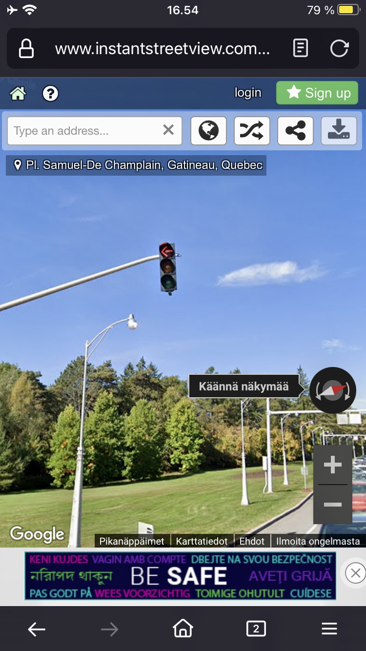

Is this the only example of a red arrow in use in Canada?
Champlain Bridge, Ottawa (at Lucerne)

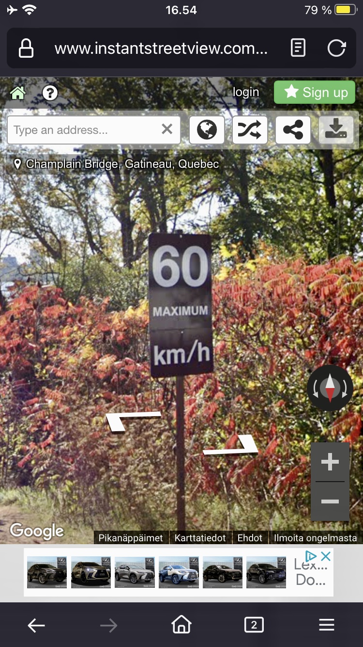

This signal is at the end of the bridge, so are these "Federal" signals? Like these are weird "Federal" speed limit signs:
I swear I've seen a red left arrow in Calgary, but accompanied by a red ball.
Ontario is the only province that explicitly forbids red arrows. There are numerous red arrows in other provinces, mostly in Québec and Alberta.
Montréal QC has lots of red arrows. For example at Rue Notre Dame & Rue Frontenac
Canmore AB has at least one intersection with red arrows: Bow Valley Trail & Railway Ave / Benchlands Trail
Calgary AB does indeed use red arrows as well. Like you said, they use them in combination with a red ball to indicate "no turn on red". Here's an example at Richmond Road & 17th Ave. I couldn't find a Streetview image with the red arrow but you can see it on the sign.
That intersection is in Gatineau QC, not Ottawa ON. The intersection on the Ontario end of the bridge has red balls instead of red arrows.
The typical interpretation has been that the ON HTA doesn't apply on federal roadways, including all National Capital Commission roadways (including but not limited to interprovincial bridges). This is why the NCC installs federal black speed limit signs instead of Ontario / Québec standard signs.
I personally don't understand why federal ownership would exempt a roadway from the HTA but if that is in fact the case, then red arrows could be installed on any NCC roadway, not just those in Québec. The signals on the Ontario end of the bridge seem to be following the City of Ottawa's standards, which are based around the HTA, which is probably just for consistency with other signals in Ottawa.

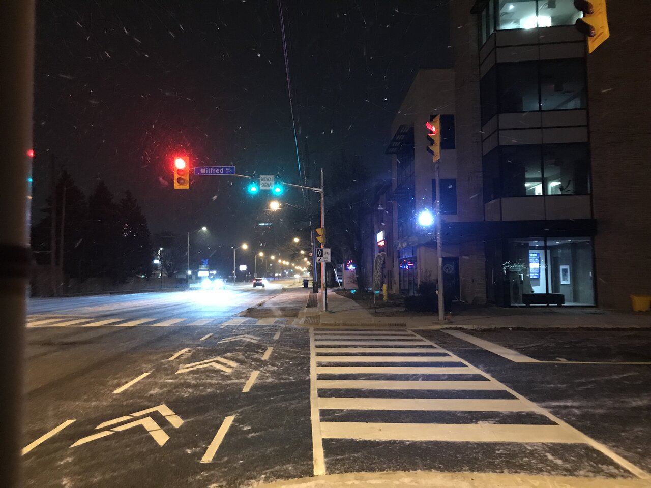

With the bike lanes completed on Sheppard, I was shocked that the City went to the trouble of installing bike signals at Wilfred, just to provide bikes the LPI.
I love these lanes, but it seems silly to go out of the way to install separate bike signals over five seconds just to provide LP(/B)I.
It's kind of like a screw you to motorists, buses, and trucks since all the signals were replaced. Toronto allows for "Ottawa" LTIs:

Edit: I went to take a photo this morning:
Guess it's a question of desire...
Adding bike signals at intersections with LPI is a good idea. It reduces the amount of unjustified red light time. Right-turning bikes do not pose a safety issue to pedestrians the same way right-turning motorists do, and adding an LBI reduces the risk of collision between right-turning motorists and cyclists travelling straight.

I agree that the City installs an unreasonably large number of signal heads, but adding bike signals at LPI intersection is not an example of that phenomenon. That said, I would personally only install a single bike signal head rather than two, with the rationale that it acts effectively as an auxilliary head for an existing signal phase (not a separate phase). The 5 s earlier green on the bike signal does not necessitate redundant heads since if the bike head fails, worst case scenario is that the cyclist waits 5s until the vehicle heads turn green.

I think the complaint was also that even though all car traffic signals were replaced with new ones at intersections where it was known there is LPI, traffic lights with a fourth aspect of a straight green arrow were not used. The cost rationale make sense not to replace every signal in the city at intersections with LPI with a four aspect one, but since the car traffic lights were replaced with new ones here anyway, is the cost really much higher to use the four aspect one?

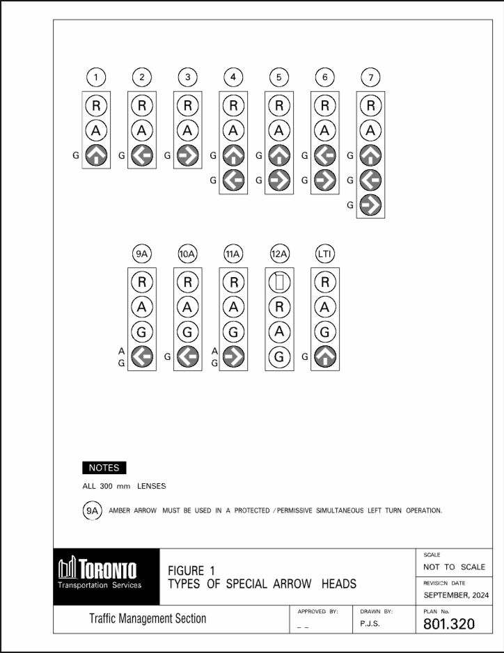

I don't know the justification behind it but in OTM book 12 (the guiding book on traffic signals), that particular signal head (number 11) is only shown with the green arrow, there is no bimodal option. Hence to conform to industry best practice Mississauga changed all of the signals, all their signal drawings only have the OTM #11 signal head as well. Right turn arrows will also be close to non existent in Mississauga eventually as well so it will be a moot point eventually.
