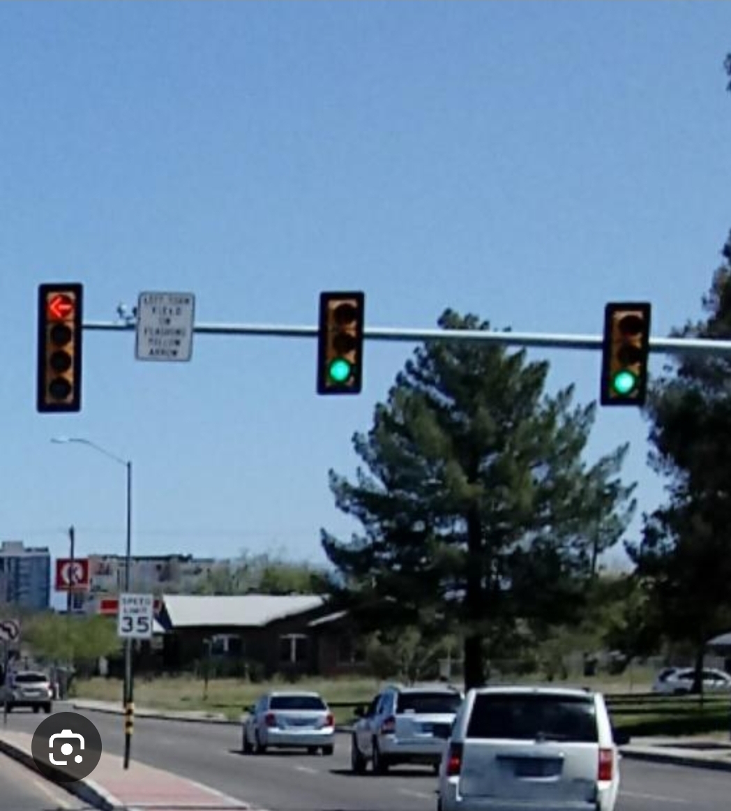

I think that the dedicated left turn signals should have red, yellow, and green arrows instead of solids. Makes it more clear what that signal is for. Besides such signals are seen in most jurisdictions, why not ontario?
I think that the dedicated left turn signals should have red, yellow, and green arrows instead of solids. Makes it more clear what that signal is for. Besides such signals are seen in most jurisdictions, why not ontario?View attachment 591024
Couple that with the left turn signal and 'regular' signal mounted on arms of equal length and the "left turn signal" mounted on a pole equidistant between them.
I'm not sure why you'd need a red arrow. A simple red should suffice. I personally find things like red arrows, and flashing red pedestrian lights confusing, with it implying go and don't go at the same time.
