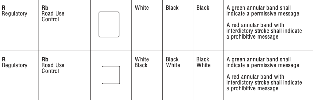

This is confirmed by the Ontario Traffic Manual itself, namely Book 1A:
"A green annular band shall indicate a permissive message" (emphasis added)
Yet Ontario Traffic Manual Book 12 claims that the bikes dismount sign means:
The DISMOUNT AND WALK sign indicates that cyclists are required to dismount and walk their bicycle in a specific area. See OTM Book 18 (Cycling Facilities) for further information on the sign.
The DISMOUNT AND WALK sign should only be used in exceptional cases, such as where an in-boulevard facility ends, and cyclists would discharge onto a sidewalk, pedestrian zone, signalized crosswalk or an area where regulations prohibit cycling. For more information on guidelines for use of this sign, see OTM Book 18 (Cycling Facilities).
On top of contradicting the fundamental principles of North American traffic sign design, it also contradicts the intent of every other green circle sign in the manual.
For example, this sign means "cycling is permitted", not "you are required to ride a bicycle"
This sign means "trucks permitted", not "you are required to drive a truck"
This sign means "hazardous goods permitted", not "you are required to have hazardous goods"
Per the MUTCD, requirements are to be communicated with a black-and-white sign, not a green circle (with specific exceptions like stop signs, yield signs etc).

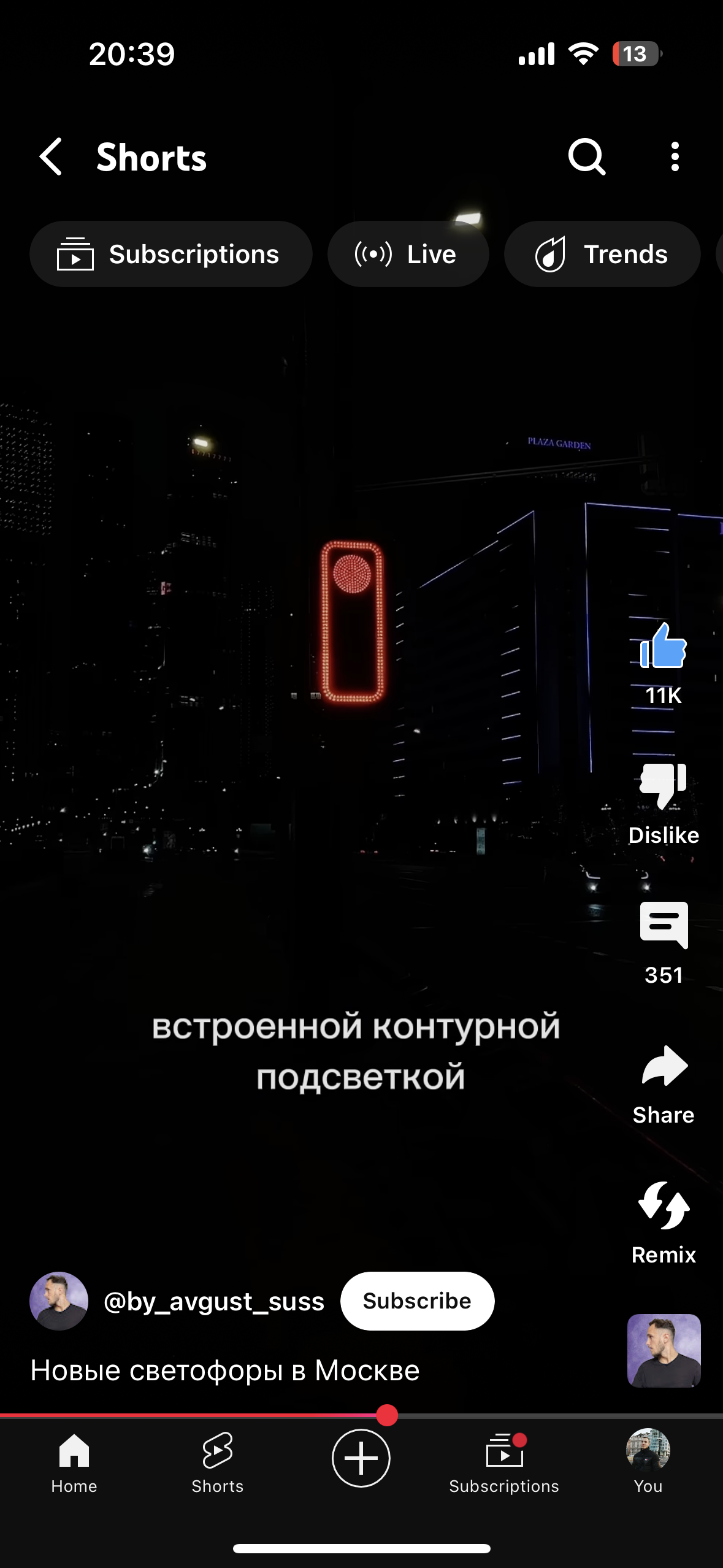

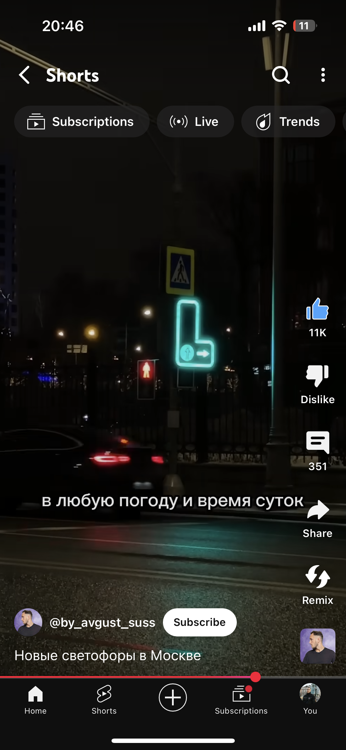

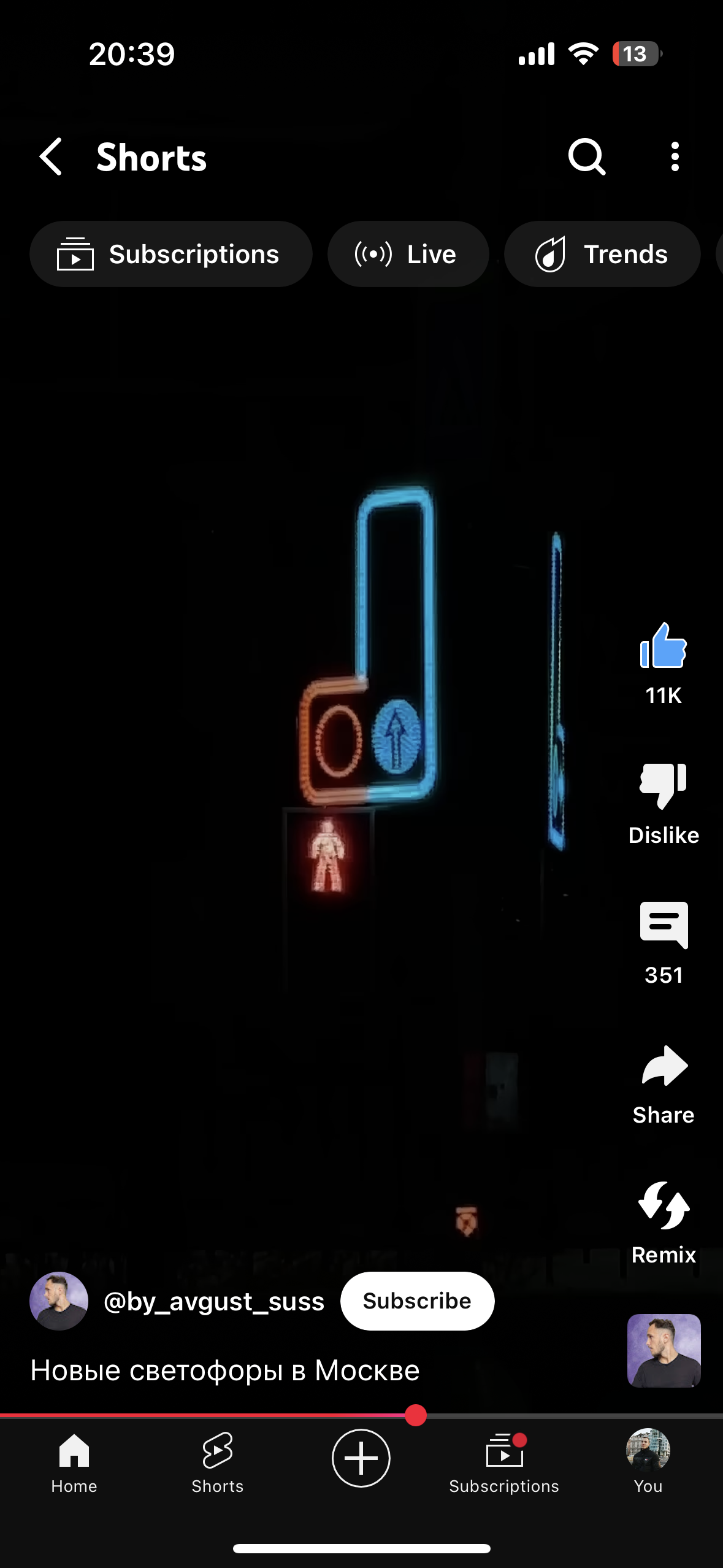

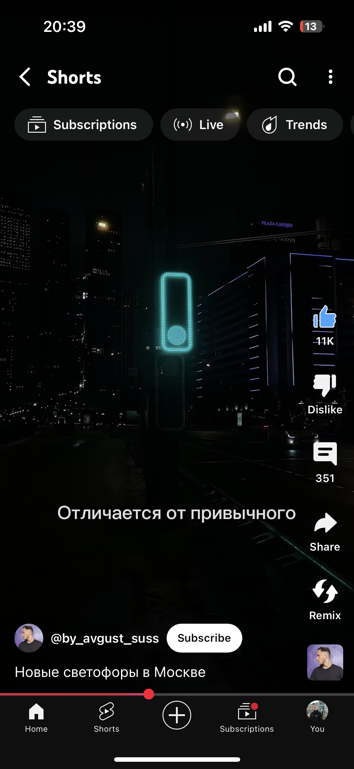

Just wanted to show new beautiful traffic lights that Moscow is currently testing, this is flat LED panel with an interesting feature - an outline that copies a colour of a signal for better attention
