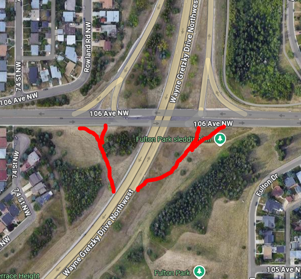

As for Gretzky Drive, we only need to fix 1 intersection. The 106 Ave interchange requires a SB exit from 106 Ave to Gretzky Drive SB and a NB exit from Gretzky Drive NB to 106 Ave.
It'll be a bit more than your drawing, there's pretty significant elevation change there, the ramps would need to be probably stretch to the "W" of Wayne Gretzky in that pic. Not sure it's necessary to be honest. Users coming down 106 Ave from Dawson bridge can use this to get North, and if they're headed south can just use 50th instead. Use the money elsewhere if you ask me.
