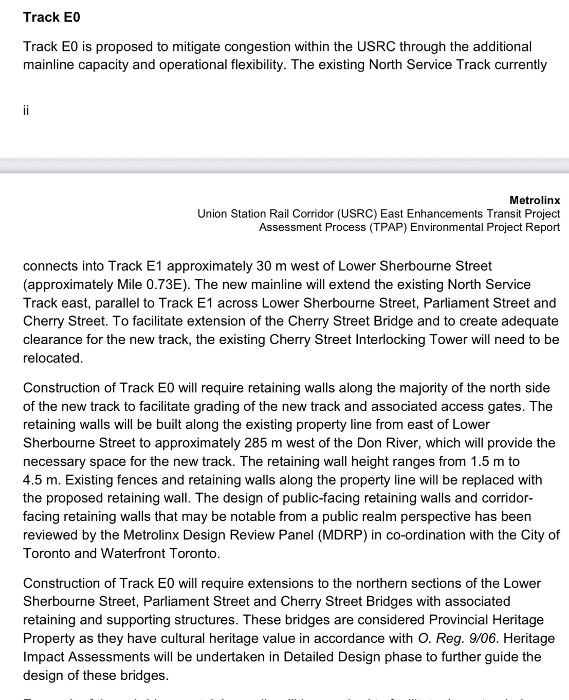

More capacity by adding a Track 7 and 8 here on the south side. There should be some documents still on Metrolinx's website if you look up Union Station Rail Corridor East Project. At one point they were going to extend Track 1 all the way past Cherry but it ran into some NIMBY opposition from St Lawrence residence.
It was certainly not welcomed by people who would have seen ca 20 feet of trees and bushes removed, blank walls erected and then have trains passing within a few feet of their windows. The new track would literally have been in their back yards and their NIMBYism was more justified than most.
I'm confused, Track E1 extends through all the way from the shed to the Bala Sub, no? Did you mean track E0?

For me the shame of losing E0 was that we were going to see Cherry Tower moved on Metrolinx’ dime and not the TTC’s…
