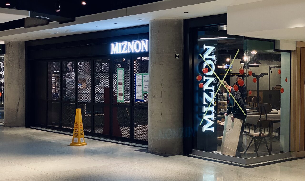

Union is really quite nice in this regard now. I hope it becomes inspiration for exactly what you describe. I feel Union has shown that stations can be neighbourhood hubs too. I'd be interested to find out how many people (other than me) go to Union for a meal even if they aren't going anywhere else in particular.
