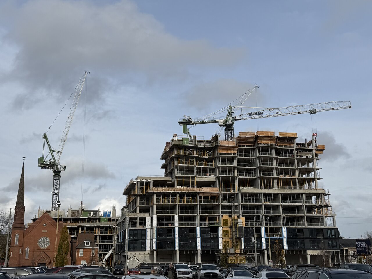

Cool video, one floor a week pour concrete this is moving fast.
I feel like this development is really going to change the perception of this little area of Hamilton. It's going to go from scary at night-parking lots, to trendy condos. Can't wait to see it. And i'm also really happy all the little shops on James will get a much needed boost. This thing is also flying up now that the podium is basically done.
Also- looks like tower 3 is happening??
There's still gonna be one scary at night parking lot - and it is the biggest one of all lol..
