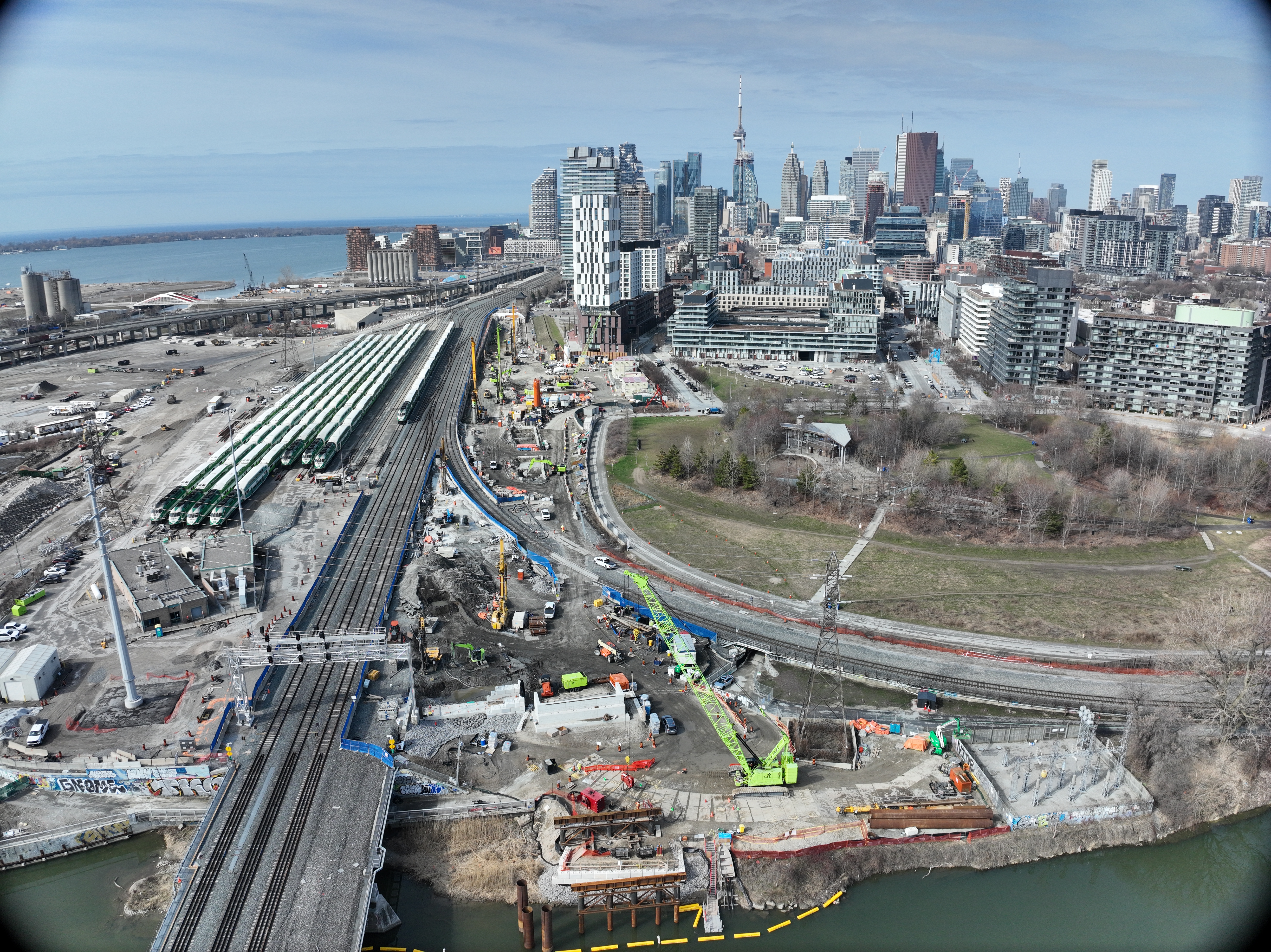

That wall is Front street, there’s another deep pit on the other side. The space between will be carved out with smaller machines then the TBM will launch from here in the opposite direction of the photo.
Is that true? I thought both are launching from Exhibition?
Pretty sure you are correct. Corktown is where their journey will end.

This is the article I'm referring to. Dated June 20, 2025. Second paragraph.
That was years ago wasn't it?
Not sure how this would make sense, TBM extraction at Queen would be a nightmare. Most recent info from MX I've read states both TBMs will launch eastward from the Ex and travel continuously to the extraction portal currently being constructed in the Don Yard, as others have stated.
I do remember a rumor on how they were going to move the tbm's across queen and osgoode, similar to how they did it for crosstown. Guess they decided against it for obvious reasons
The TBMs will travel from Exhibition to Don Yard portal.
After the last push through the portal headwall, the cutter heads will be retrieved at Don Yard. The shields will be buried underneath the portal (cut and cover portion). The backup gantries will travel back and be retrieved at Corktown South shaft.
Cheers for that. So my information about the westbound TBM is outdated. As for the Don Yard it seems we were both correct - the TBM is traveling there but not being extracted there.
