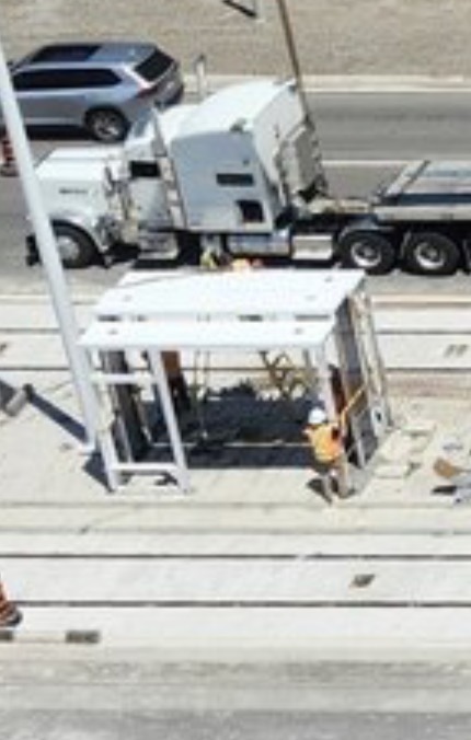

Is that an enclosed waiting area at the north end?
No enclose areas for any stations and are supposed to be the same as Derry that was installed in 2024. Once those sections are in place, the roof will go up in large sections. All the stations other than Derry needs a lot of extra work to install the missing pieces including the small amount for Derry on the east side. Then there is the platform edges slabes to be install as well.

So what is this section that looks like an enclosure? It looks completely different than the Derry Station platform canopy.
I will have to take a look tomorrow on my way into Toronto to see if this is different than Derry. Every station from Eglinton North is the same as Derry at this time. The frames arrives inside of another frame until it is in position for protection
Ah that makes sense then! These look like it could be 3 frames just packed together.

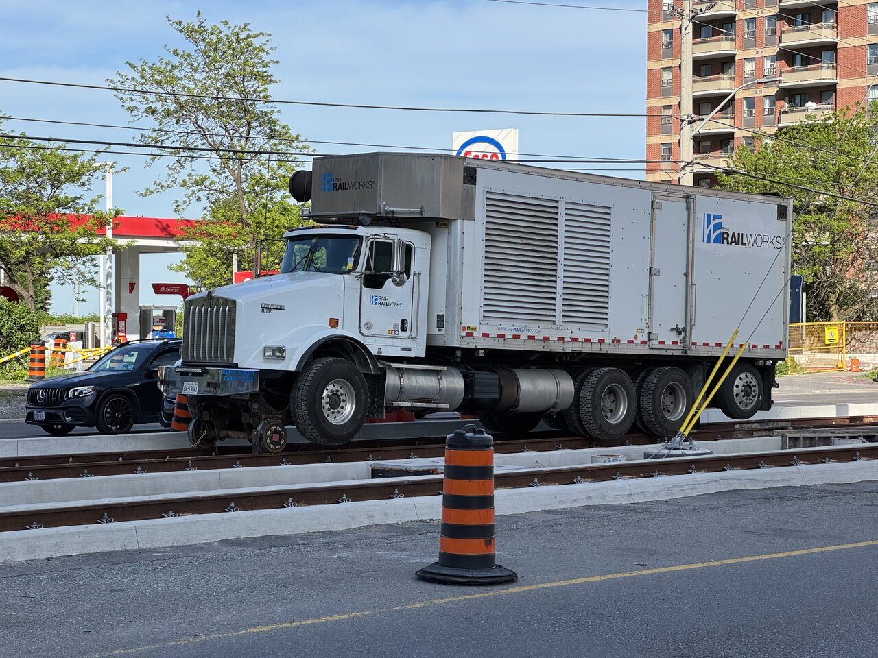

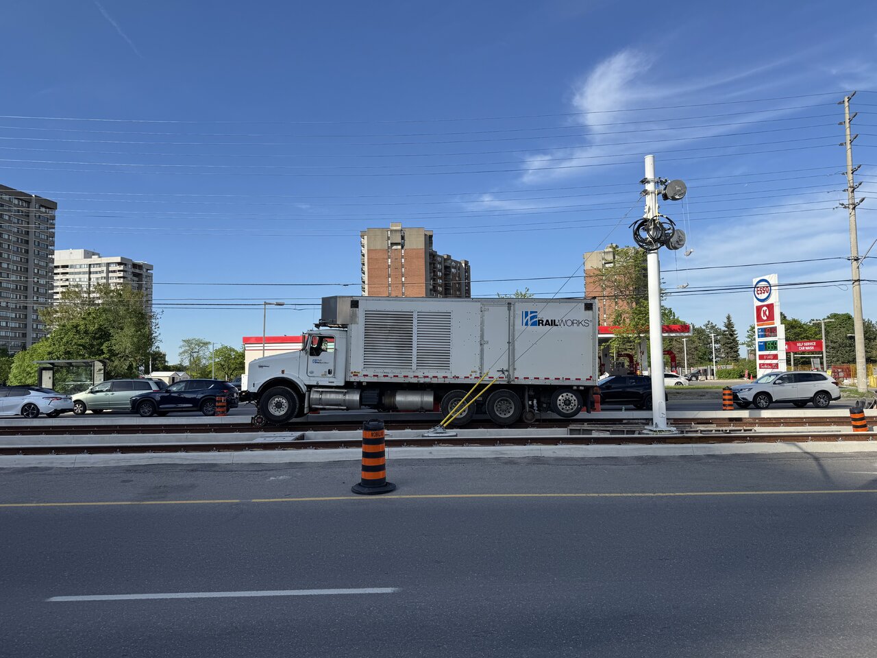

One of these trucks on the rails just south of Central Pkwy.
View attachment 739487View attachment 739488
It and others have been splicing rails joints after the rails have been in place for some time. Anchor bolts for the rail clips are loosened to allow the rail clips to rise that will allow the rail to expand for stress test, expansion so any excess rail can be cut out.

The lane beside the guideway is close as well at the ends that are current block off all the times while splicing is taking place. Crews will open the area for the truck to setup on the track and close it after the truck moves. They has been trucks in that close lane that will splice rails together before the rails are place on ties as well doing the final splicing.

@Tuscani01 Did not make to Robert Speck Station until today and the cookie cutter Derry Station is there with the roof missing which is normal. The photo in question is the three panels in creates side by side like they have been like other stations I have seen so far. Have photos but behind a backlog at this time.
