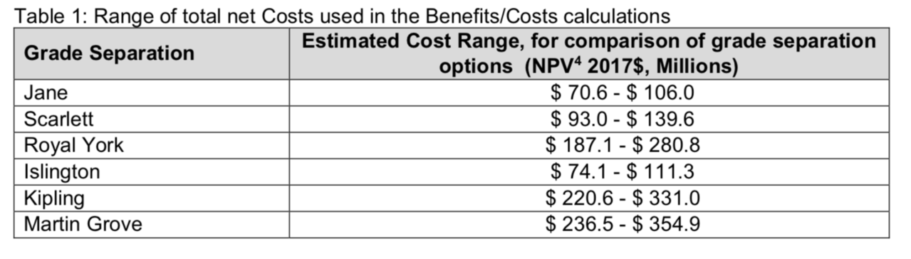

Spotted a massive difference in the cost estimates for grade separations, according to the two recently published reports:
https://drive.google.com/file/d/1jrzqfHhIJoRSvVTwwKvVzCDh33dfu1ZH/view
Versus
https://www.toronto.ca/legdocs/mmis/2017/ex/bgrd/backgroundfile-109250.pdf
In the first document, they use "$" for 0-50 million and "$$$" for 100 - 150 million.
Islington comes at "$", 0-50 M.
Each of Jane, Scarlett, Royal York, Kipling, Martin Grove comes at "$$$", or between $100 M and $150 M
In the second document:
Jane 70.6 to 106.0
Scarlett 93.0 to 139.6
Royal York 187.1 to 280.8
Islington 74.1 to 111.3
Kipling 220.6 to 331.0
Martin Grove 236.5 to 354.9
Either I miss something in undertanding of those reports, or they miss something in one of the reports (or both).
Royal York, Kipling, Martin Grove (underground options) come roughly twice more expensive in the second report than in the first report.
Islington (elevated) is roughly twice more expensive as well.
Scarlett (elevated) is about same.
Jane (elevated) is actually cheaper according to the second report than according to the first.
How is that all possible?
Versus
Jane 70.6 to 106.0
Probably a genuine error by whoever wrote the report.
I'd trust the numerical values, and ignore the dumb "$$$$$" meter. Particularly because the numerical values have more precision than the "$$$$$$" meter, which seems to round to the nearest 50-millionth. And, for what its worth, the values on the Eglinton West LRT website match the numerical values
The Part 1 Report costs are parametric costing according to the assumption page (very high level; use cost of comparative projects to estimate) while the numeric costs are Class 4/5 according to the staff report, which are more detailed though still preliminary. I imagine the parametric costs were used to test for initial feasibility before developing the Class estimates for the options moving forward.
