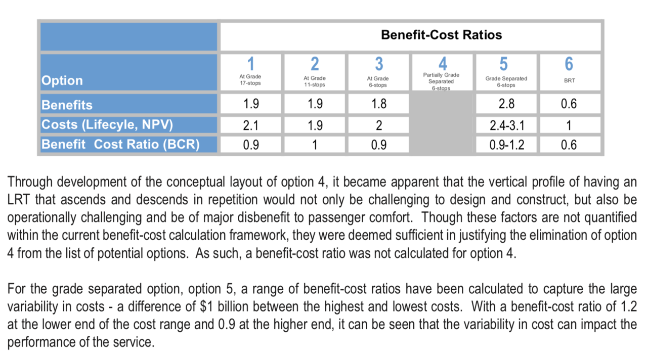

Has anyone managed to explain why;
  • the highest performing option (and the only option with a benefit cost ratio greater than unity ) from the 2016 initial business case study - which is fully grade-separated,
  • was not looked at in the October 2017 LRT study, where not servicing the mid-block stops was considered a fatal flaw.
Even is we do business cases, the results are ignored. The same thing happened on the Eglinton East portion where the connected ECLRT/SRT was found to be best, and then the only options considered thereafter were the subway extension and the transfer LRT.
I did find this study. - which I suppose is why they decided those mid-block stops were so important. (although no benefit cost numbers were run to determine what the effect would be on ridership).
The 2009 BCA also found grade separation to be the best performing. However, in that report, they severely underestimated by speed of the at-grade option by 25%. Without that error, the results of the BCA would likely be different.
I suspect they made a similar error in the 2016 BCA. Unfortunately they do not provide a list of what assumptions they used, regarding the operation of the transit line, so its impossible to say for certain.
City Planning has recommended that the midblock stops not be built. The October 2017 report you linked to considered not servicing mid-block stops as a fatal flaw, presumably because they wanted it to be possible to serve those mid block stops, if the need arises in the future.
Why are you so concerned about them not looking at 100% grade separation? It would certainly be more expensive than targeted grade separations at each individual intersection, and would not be any better performing for transit users.
Then they should either correct their error - or don't bother doing any studies since we can't rely on anything that they produce.
If they do a study that say grade-separated is best, then is it not reasonable to consider that as the best option, and any subsequent reports would have to find new evidence to disprove or alter the analysis.
If we aren't going to follow the results of the studies, then we are asking all decisions to be made on political whim, or by vocal NIMBY's.
100% grade separation was the best performing in the BCA, only at the low end of its $2.0 to 3.0 Billion price range.
