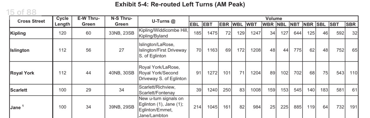

b) the additional probability of red light delays at the intermediate intersections, which is caused by the use of these intermediaute intersections as u-turn points for autos turning left. These delays were not quantified but the volume of left turning cars is shown to be considerable so one assumes that large amounts of the traffic cycle will conflict with LRT operation
While the delays at due to modified left turns (via u-turns approx. 200 metres downstream) were not qualitified, the EA authors did analyze its performance, and were quite equivocal that they did not expect this to have a significant negative affect on transit operations. We see this reflected in their expectation that the trams will run at 30 kph between Jane and Renforth.
They also mention that this strategy had been implemented successfully in several other cities.
The data we’re interested in is the NBL and SBL. The worst here is NBL at Jane, with 225 cars per hour. This is about 3.75 cars per minute.
U-turn phase lengths aren’t specified, however it seems reasonable to me that with a cycle length of 120 seconds, we could get 8 cars to make a u-turn with a 15-20 second u-turn phase.
Consider that a train would be coming once every 3 to 4 minutes. With a 20 second u-turn phase every 120 seconds, the probability of the train having coming up against a red light at any individual u-turning intersection is just 11% (I hope I’m remembering my probability correctly). And this is the worse case scenario, where there is no transit signal priority, where all u-turning intersections have traffic volume to justify 20 second u-turn phases, and where it is assumed a u-turn phase will be actuated 100% of the time. And even when the train does come up to a red light, it’s stopped for at most 20 seconds - not a huge delay.
It’s rough math, but it gives us an idea of how these u-turn lanes will affect operations. I agree with the EA authors that this will not have a significant negative impact on operations.
