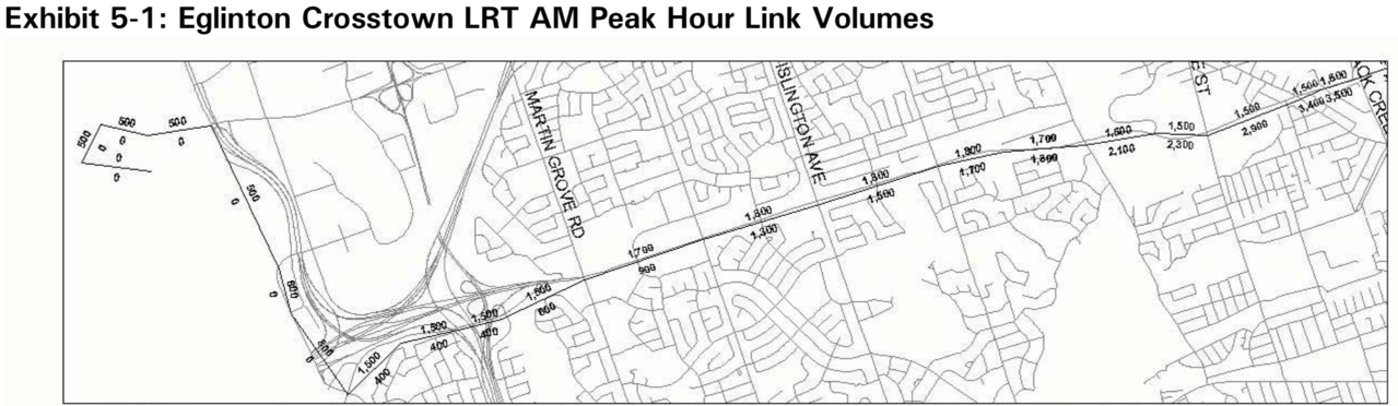

Here is the ridership at each station, from the Transit City EA:
Lets weight the cost of grade separation, with the ridership at each stop and potential time savings: This is cost per minute saved per passenger.

Jane: Time savings of 30 seconds with 3,800 AM peak passengers at a cost of between $70.5 and $106 Million
$618 per second per passenger to $929 per second per passenger
Scarlett Road: Time savings of 33.8 seconds with 3,300 AM peak passengers at a cost of between $187.1 and $280.8 million
$842 per second per passenger to $1263 per second per passenger
Royal York: Time savings of 23.4 seconds with 3,300 AM peak passengers at a cost of between $93.1 and $139.6 million
$2,454 per second per passenger to $3,636 per second per passenger
Islington: Time savings of 15.2 seconds with 3,100 AM peak passengers at a cost of between $74 and $111.3 million
$1,570 per second per passenger to $2,361 per second per passenger
Kipling: Time savings of 25.6 seconds with 2,700 AM peak passengers at a cost of between$220.6 and $331 million
$3,214 per second per passenger to $4,814 per second per passenger
Martin Grove: Time savings of 31.2 seconds with 2,350 AM peak passengers at a cost of between $70.5 and $106 Million
$3,225 per second per passenger to $4,829 per second per passenger
