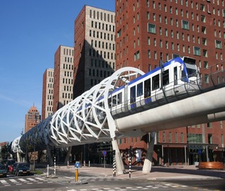

BurlOak:
I thought about centre of the road, but I thought the stations may be too daunting in the middle of the road. Even comparing the SRT, Brimley looks reasonably elegant, but Midland the station just dominates - and that still is not entirely in the median. If the station is in the median, it could have less height with 2 side platforms instead of 1 centre platform, but then passengers could not access both sides of Eglinton. If the station has a separate mezzanine level and platform level, it just becomes that much larger of a structure in the middle of the road.
Bad model - should reference Brentwood Station in Vancouver instead:
http://goo.gl/maps/2G4mR
It's large, but not unbearably so. In any case, looking at the routing of Skytrain it seems to take advantage of a lot of leftover spaces that the Eglinton line doesn't have.
Also, a side station would be much less disruptive during construction and the station could be more easily integrated into adjacent developments when it is at the side of the road. There is not that much there now, so I do not think the adjacent properties would be too negatively affected. Bening on the South, there is less concerns about blocking out the sun. A glass enclosure around the tracks in the vicinity of any building would also reduce the impact.
The issue isn't so much so what's there now, but what might be there in the future - running the elevated line so close to the properties will create resistance and future development problems regardless of whether you put an enclosure or not (and those noise barriers tend to be bulky, which makes the problem even worse).
