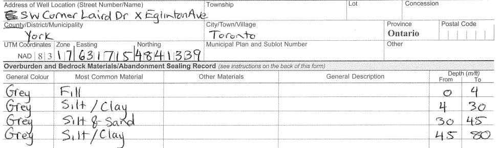

considering the cavern containing Laird station was built using Sequential Excavation I highly doubt that the soil conditions and water table issues wouldn't have been noticed and appropriately remedied. After all, the entire cavern for Laird was mined to 489m long to also accommodate the storage track and crossover.
It's different geology at Laird. The issue is was at Bayview - Leaside station, not at Laird station.
You can see a typical Leaside borehole log at https://files.ontario.ca/moe_mapping/downloads/2Water/Wells_pdfs/727/7278792.pdf - as you can see from 30 feet to 60 feet is sand, with sandy clay/silt on top, and clay underneath.
But at Laird (https://files.ontario.ca/moe_mapping/downloads/2Water/Wells_pdfs/726/7263118.pdf) there's silt in the matrix all the way to the bottom, at 80 feet.
I think the log I did in the 1990s said "flowing sands" - but it was a long time ago - and before drillers had to submit their own (typically under-described) logs to the Ministry.
Laird Station
Leaside Station
