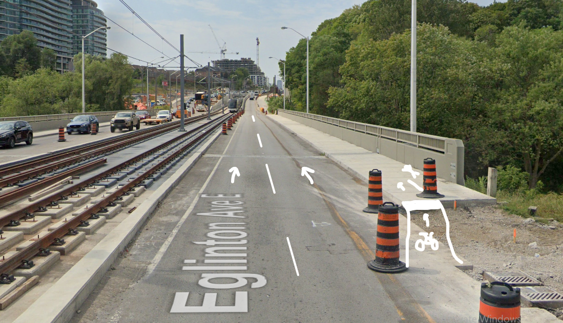

Drove through Eglinton and Leslie yesterday, and it appears that Eglinton will be permanently one lane over the Sunnybrook ravine on the westbound portion. At least I don't see how they are squeezing in another lane without expanding the bridge and keeping the sidewalk. Is that actually the case?

It'll be tight, but two lanes will fit. Although, the bike lane will temporarily merge on to the sidewalk over the bridge.

The bridge will be tight and gross feeling for all users but technically it will work. I was referring to the CP underpass just up the hill, east of Leslie…
It’s just as tight if not slightly tighter than the bridge over the branch of the Don. But. The eastbound road lanes are also going to do a super awkward “jog to the left” after the LRT platform in the short uphill distance to make it into position before the underpass. Add the bike lanes and IMO it’s a total clusterf**k. They should have splurged to widen the CP bridge. Or. They should have diverted the sidewalks/bike lanes into separate new tunnels on either side of the existing road allowance. But alas. This is Toronto what was I expecting. Half assed will suffice.

From what I know this isn't true. The tunnel under the ravine still would've been in the ball park of 40m deep - which would've killed the idea of a station at Leslie. Really all that should've been done was they widened the bridge like they did, but put the tracks on the south side of Eglinton, rather than the median.
This is something that Toronto cannot fathom to do. I believe it has to do with our history of streetcar tracks in the middle of the road. Other places put LRT's on one side of the ROW and roads on the other, often also putting bike lanes in their own dedicated 2 way strip as well. We can't seem to figure this out. It makes way more sense this way and is safer for everyone, rather than mixing cars, LRTs and bike lanes on each side.
The big advantage to this too, down the entire strip of at-grade, is that LRT's are less impeded by traffic. You can have cars turn left and right at the intersection on one side while the LRT can still go through on the other. You don't have the issue of left hand turn lanes taking up space. Its easier to install crossing arms for the LRT as its only crossing one road and have much more dedicated service. It results in less collisions. People dont have to wait at stops that are in the middle of the roadway and potentially can get hit by a car while crossing etc. Bikeways can be put on the other side of the LRT, well away from traffic, where its much safer.

Early on in the consultation process, I asked one of the planners whether a south-side alignment was looked at between the portals at Brentcliffe and Don Mills. The response that he gave me was that it had been, but was felt to be not ideal for two reasons. The first was that it made transfers worse at Leslie, and the second was because the City planned to keep the grade-separated interchange at the west end of the former Celestica property. Apparently the then-projected traffic levels into and out of that new neighbourhood would have caused severe traffic congestion had that been left as an at-grade intersection.
Of course, the City had planned to remove the grade separated interchange at Wynford as part of the Crosstown, so I'm a bit torn in terms of what to believe.

That interchange will be retained now from my understanding, though the slip ramps will be changed to stop-signed controlled intersections. The underpass under Eglinton will remain.
