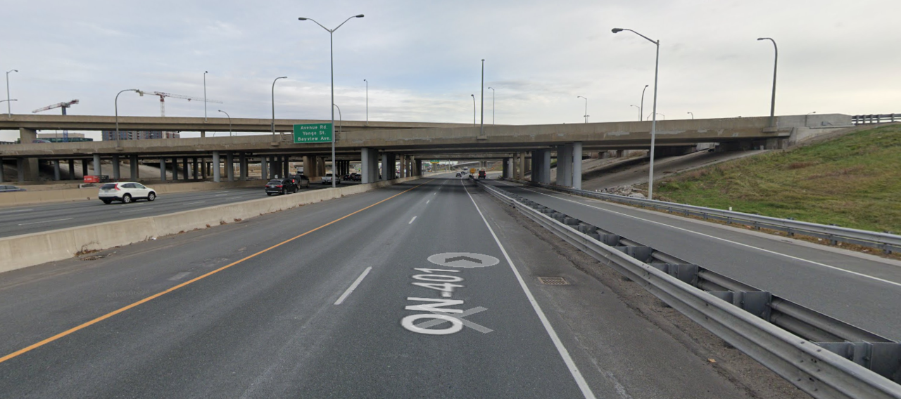

The only thing this notice doesn't tell us what is the off loading time and assuming at night. Not sure why the LRV cannot stay on the 401 between Dufferin St and Bathurst St unless there is an overhead issue
Assuming the transportation of the vehicles will take place over night (after midnight and before morning), to avoid the traffic. Assuming actual off-loading would take place on the right-of-way during the day.
The article states that the first vehicle will be walked over the line with an eye to ensuring there are no clearance problems. I would expect that would be done during daylight for reasons of visibility. I wonder whether both tracks will be tested on successive nights Once that is done it makes sense to move the rest at night when traffic is quieter.
