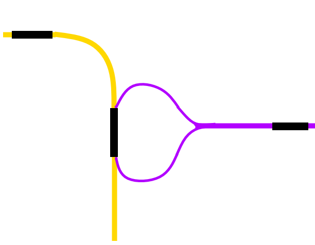

Is something like this possible?
Yes, but that purple circle will be big - maybe a kilometer.
Going WestBound, there is a (~45 degree) right curve with 300m radius minimum, followed by a (~135 degree) left curve. There is then a minimum 150m platform, followed by the same in reverse (135 degree and 45 degree curves) until you are now facing East Bound. Add to each of those distances some spirals (the gradual transition from a straight portion to a curve) and you are talking a pretty big circle.
