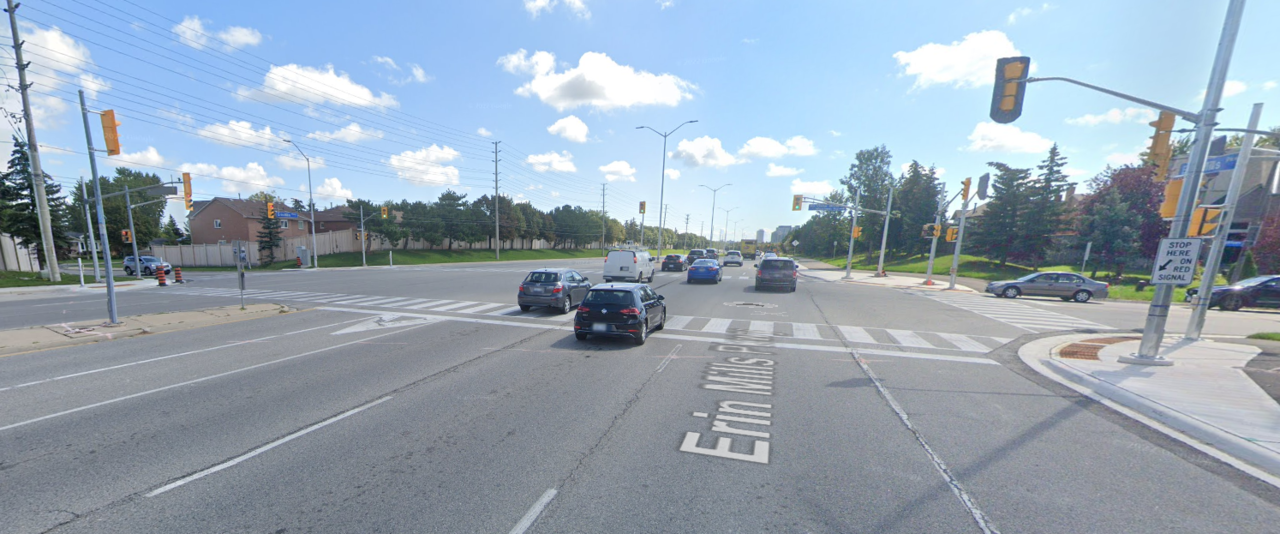

I feel like one of the challenges we have in the GTA that is not seen much in NL, is the preponderance of 6 lane arterials. It makes sense that the intersections of these roads need to be signalized. But intersections with minor collectors should maybe be more RIRO and unsignalized, and replace the lights with centre refuge islands and pedestrian cross-overs. The signals should also be timed in a way to coordinate with the neighbouring intersections and the speed limit, which could help with traffic calming and minimize delay for pedestrians to cross
I have to question if these 6 lane monstrosities are even warranted.
6-lane arterials are indeed less common in NL than they are here, but 4-lane arterials are quite common and pedestrians need grade separated or signalized crossing facilities either way.
