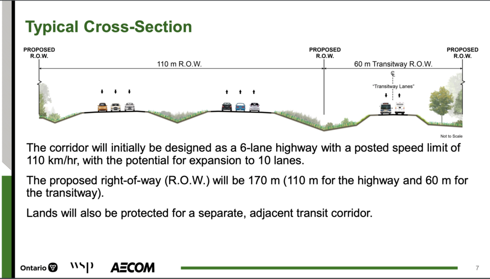

The 413 is planned to be built as a 4-6 lane freeway like the original 407 cross section- it is designed in mind for future expansion. From what you're saying, we should be building the ultimate design from the ground now to save money and construction headaches in the future, or nothing at all.
The 413 protection will be for a 10 lane freeway. On top of that there's also protection for a transitway, who knows if that will ever get built.
Is this badly written, or are they protecting a 60m transitway as part of the 170m ROW, and on top of that an additional transit corridor?
Why would they not build it with centre barriers from the get go??
$$$. Building it as a 10-lane facility would add cost for a facility that doesn't have the demand yet.
The original plan was for only part of the 413 to be 6 lanes, yet alone 10. They are now building it as 6-lanes across the entire corridor, but 10 would be overkill.
It's being protected for 10 lanes like the 407 was when it was built, which means it will be inexpensive for MTO to add the lanes as they are needed.
Yeah, I was also confused.
I think it's just bad ordering. First, and third paragraphs, 10 lane highway and land protected for transit corridor. Second paragraph gives details on the combined ROW width.
Is having the 6 lanes in their final centre position with concrete barrier more costly than having them separated with a grass gap in between? Such as needing longer on and off ramp? Or are they other considerations like having it start off taking up more of the right of way rather than leaving gaps on the edges?
I'm guessing drainage is more complex.
