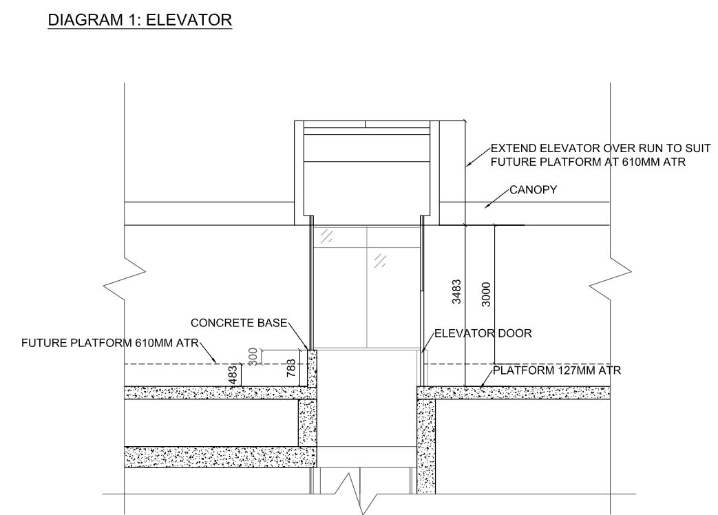

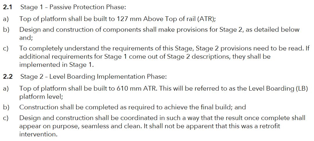

Metrolinx has selected 610mm ATR as the future level boarding height. That's the lower level of the bilevel cars. I have always favoured 1220mm thanks to the greater rolling stock flexibility, and standardisation with VIA, Amtrak, UPX, Exo, MBTA, CT Rail, Metro North, LIRR, NJ Transit, SEPTA, MARC and RTD, but sadly that ship has already sailed.
All new stations since 2017 have been future-proofed to be raised to 610mm. You will notice features such as weirdly tall concrete bases on columns (so that the mounting points stick out above the future platform height), entrances which are too high for the current platform (to line up with the future 610mm platform), and larger than expected spaces between tracks (to make room for a bypass track or gauntlet track for freight trains to bypass the higher platforms).

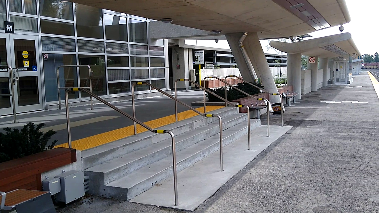

Downsview Park Station (opened 2017): note the height of the entrance onto the platform
note the space for a centre 3rd track:
Bloomington Station (opened 2021), note the height of the entrance onto the platform. The station is also on a siding used exclusively by GO.
Rutherford Station (reconstructed 2022), note tall foundations for pillars and shelters, and space for a centre 3rd track
The reason that these stations are initially built with 127mm platforms is that GO still hasn't started retrofitting its coaches with an adjustable step to handle both platform heights. Until all coaches on a given line are retrofitted, not a single platform can be raised since there would be a massive gap for people to jump over.
It is incredibly frustrating that work has not yet begun on the rolling stock retrofits, because the longer we wait, the more new platforms get built at 127mm which need to be retrofitted later. It's not like the future consortium is going to propose selling all 750 Bombardier Bilevel coaches and buying an all-new fleet. At least part of the current fleet will stick around through GO Expansion to operate regional and commuter express services. There is also no chance that the consortium would overturn the decision to standardize at 610mm given the amount of work which has already been done to future-proof for 610mm.
