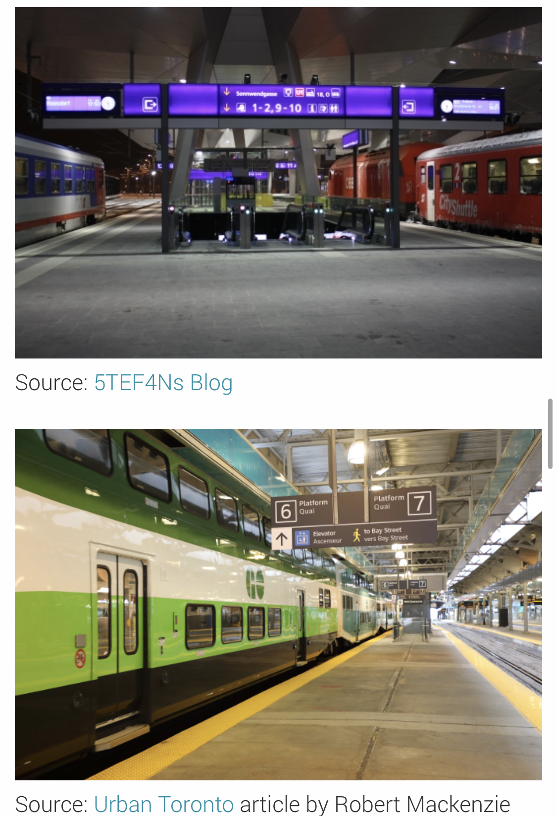

In my (admittedly: highly subjective and selective) observation, the main choke point is not the horizontal egress from the train, but the vertical egress from the platform to the passenger concourses…
As we’ve discussed on the VIA Rail thread a few months ago, Toronto Union is not Wien Hauptbahnhof:
Absolutely true today; and restructuring Union platforms is intended which they seem to think will be sufficient.

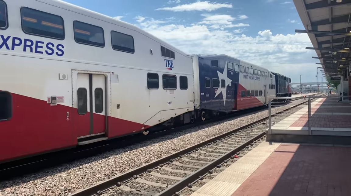

610 mm (24") seems like it is becoming the standard for low-floor level boarding in the western and southern States. Although it's unfortunate that GO has rejected the standard height used by every system near Toronto, at least there will be some off-the-shelf 610mm DMUs and coaches available. The Stadler FLIRT trains used in Texas and California have level boarding at 610mm, and those states also run Bombardier Bilevel coaches. But the Bilevel coaches haven't been retrofitted with adjustable steps, so stations used by both types have multiple platform heights, even though the trains have the same interior floor height.
Fort Worth Central Station, raised platform segment for Stadler FLIRT trains (screenshot from this video).
San Bernardino Transit Center, raised platform segments for Stadler FLIRT trains (from Streetview)
