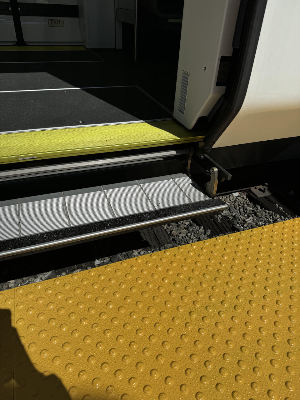

Just got off the new electric Stadler KISS Caltrain EMUs.
In terms of platform height and the process of migrating the system from one standard to the other, one thing that can work is retractable steps. So whole stations can be lifted individually, and the work can be staged.

What would the MTBF of those steps be in a snow/salt setup as here? Climate wise Northern California would seem much more forgiving, and I doubt the Swiss carpet bomb their station exteriors in salt.

View attachment 598428View attachment 598429
Yeah an adjustable step is pretty much the only way of transitioning from status quo to level boarding without shutting down a line for months, though I'm not sure if CalTrain's is actually capable of level boarding considering their level boarding platforms are planned to be at 50" (hence the doors on the middle level).
But I heard an unverified rumor that Alstom has determined that it isn't possible to retrofit an adjustable step to our BiLevel coaches. Which would explain why we're still stuck in the 'future-proofing' stage nearly a decade after establishing the 610mm level boarding standard - they should have been raising platforms by now. If true, it would add a complication to Alstom's original proposal to keep nearly all of the current BiLevels post-electrification. If EMUs could provide level boarding while BiLevel coaches can't, that tips the balance a bit more in favour of EMUs than they might have originally estimated.

Where did you hear this rumor from?
I feel like this is not true, and might just be impossible to do and be cheaper than buying new cars.

Whereas I do understand how a step may bridge the gap to a platform which is significantly lower than the boarding height, I fail to see how it could achieve the same to a platform which is significantly higher than the boarding height…
Who said anything about a platform higher than the floor of the train?
The situations the GO train needs to handle are:
127mm platform to 610mm train, and
610mm platform to 610mm train.
