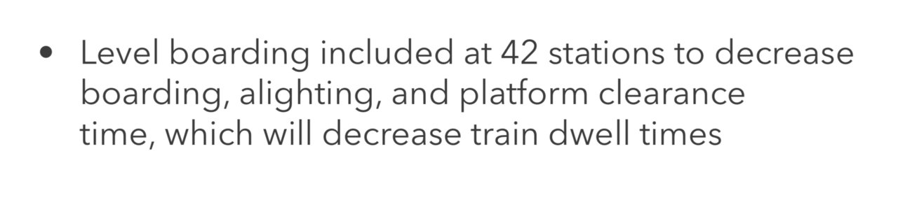

Other than UPX, what GO are trying are *level boarding* platforms, not high ones. These will be of no use for what are ostensibly the RER trains. If station platforms and tracks are increased to four, it might be necessary to do as some other nations do, Germany immediately comes to mind, where one side of a platform has a lower track bed suffice to render a high-platform, and the other side, being not as deep a trackbed, renders level boarding.
image-jpg.40648

The real question: what do they mean by "Level Boarding"? Are we going with the 48" Platform heights or heights similar to those found on the existing GO Network?
And with regards to escalators at union, why didn't they do this when they were doing the renovation? This is going to cost significantly more and make the place even more of a nightmare. Let's just hope all the food options in Bay are good when it opens.
