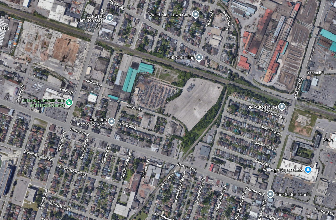

You were thinking of sending CP down the 'Belt Line" ?
I was referring to the Grimsby sub. In terms of how to get there it looks like there's room to build some sort of temporary track connection between the CP yards and that sub, although I can't comment on the logistics of such a maneuver. Is that the "Belt Line" you're referring to?
