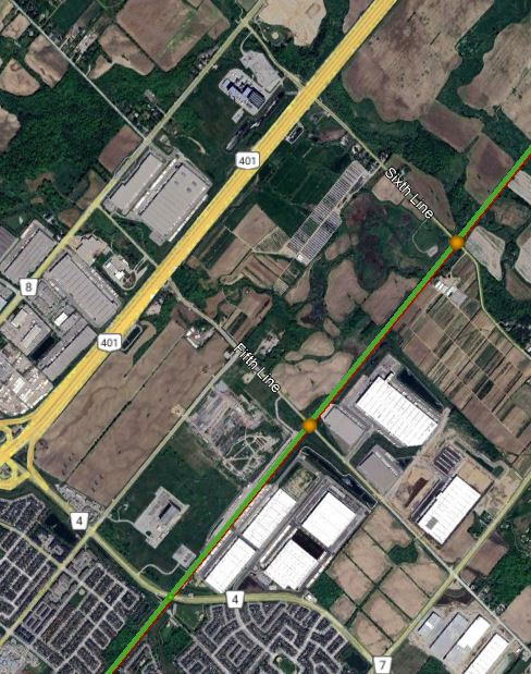

Here are the level crossings along the line currently:
Level crossings in orange, grade separations in green

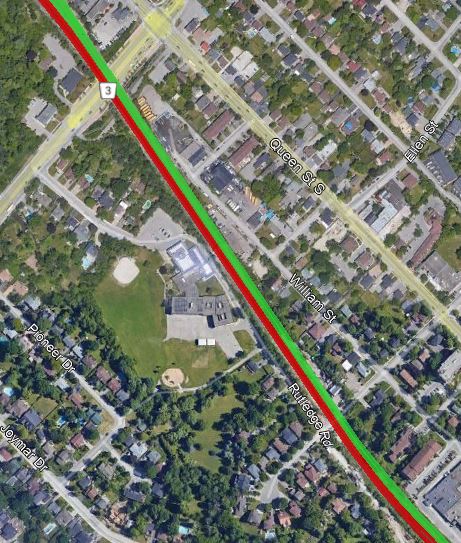

Well given that they stated that one of CPKC's demands was full grade separation, I assume they costed out full road/rail grade separations at all existing road crossings. However, several of them could probably be omitted or scaled back to save a lot of costs. Here are some ideas to do so:
Loreland Ave: it's just the driveway for two properties. Would CPKC really back out of the deal if we left this level crossing in place, but agreed to remove every other level crossing?
Haines Rd: Does this really need to be a full motor vehicle grade separation? The road is only a block long anyway, so closing it to motor traffic would cause minimal inconvenience.
A pedestrian/bicycle grade separation could be provided to maintain local connectivity at a fraction of the cost of a full road/rail grade separation.
Ontario Ct: This crossing can just be closed and replaced with a pedestrian bridge. It only really serves 20 houses that are already connected in both directions via Rutledge Road anyway.
Thinking bigger picture in Streetsville: do we even want motor traffic to be crossing the tracks in the centre of Streetsville? Providing that connection encourages people to use the town centre as a driving shortcut, which negatively impacts the safety and attractiveness of walking/cycling on the narrow streets in the town centre, and thereby generates avoidable car traffic. Based on the Dutch Sustainable Safety principles, all of these crossings would be closed to private motor traffic and be replaced with pedestrian/cycling grade separations. Drivers would need to cross the tracks via the roads that are actually suitable as through traffic routes, namely Eglinton and Britannia (which are already grade separated). This would transform Thomas/Bristol and Queen Street into quiet streets that could become very attractive routes for walking/rolling, cycling, e-biking, e-scootering even though there isn't necessarily space for dedicated cycling infrastructure. That would make those modes much more attractive ways to get to get across town or to/from the centre of Streetsville.
The biggest issue with closing all those is that it would also block MiWay Route 44 Missisauga Road that currently runs straight down Queen Street here (it doesn't serve Streetsville Station). To mitigate that impact on transit service, the Streetsville Station busway could be extended 440 metres along the tracks to Queen Street. This would save a ton of time for buses serving the station, since they currently need to backtrack 1km to Thomas Street after serving the dead-end bus terminal.
Miway Route 9 would be unchanged apart from the elimination of that backtrack at Streetsville Station.
Miway Route 10 could be extended to Streetsville Station which would also provide a new cross-town connection via a transfer to route 9 using the station's pedestrian tunnel.
Miway Route 44 would gain a connection to Streetsville Station but the walking distance from bus stops to downtown Streetsville would increase by up to 300 m.
Miway Route 46 could be extended from Erin Mills Town Centre terminal to Streetsville Station, connecting its neighbourhoods and that terminal to the station.
With private motor traffic blocked from cutting through the centre of Streetsville, there would be minimal traffic getting in the way of buses. Sure, driving around the block is a bit inconvenient, but is it really worth hundreds of millions of dollars to build a railway trench through Streetsville, just to enable cars to continue degrading the safety and attractiveness of central Streetsville?
