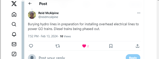

Shot of from inside the pit tweeted just now.
It has a video and here two relevant screenshots.
