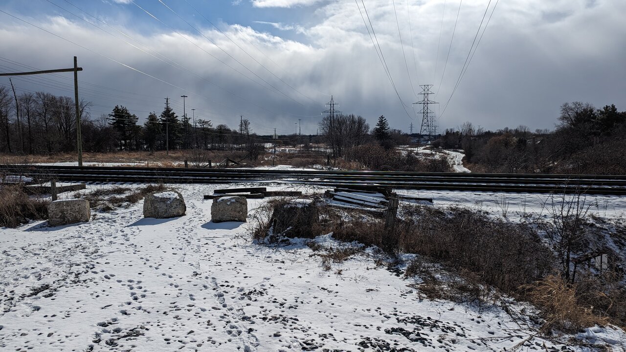

A bit tangential, but creating some kind of bus interchange here would also be a great opportunity to create an active transport crossing under the line. I was where the utility corridor meets the tracks yesterday, and together with the Credit River, it's such a barrier between neighbourhoods, the Riverwood Conservancy, and Hewick Meadows.

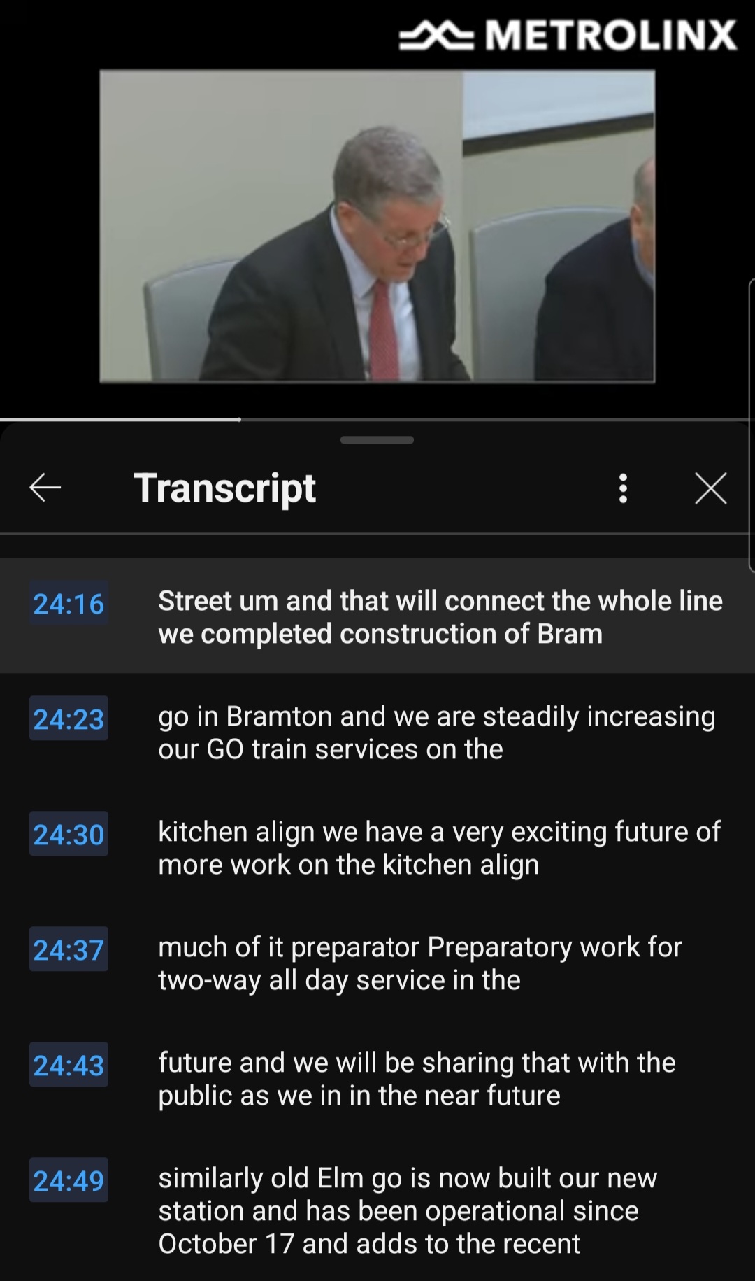

Re CN and the Halton Sub reference in the report noted above, this part of the CEO report (given verbally) at the the Metrolinx board meeting last week might be relevant. Reference to news in the future for the Kitchener Line. Time-marked link here and transcript below.
