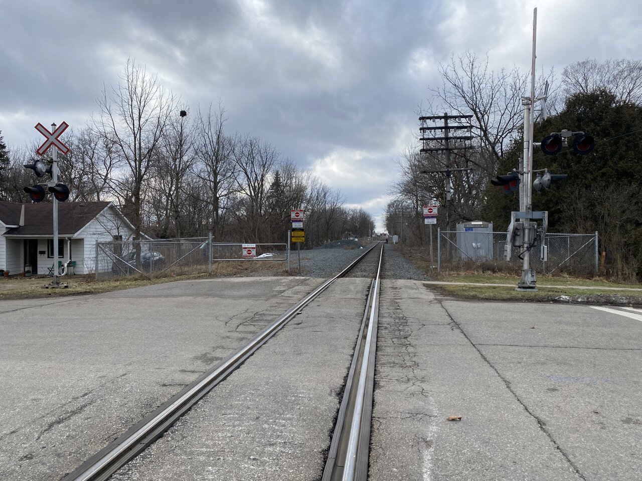

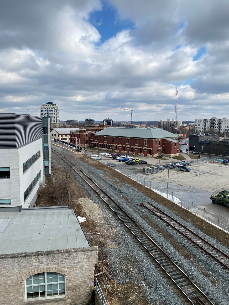

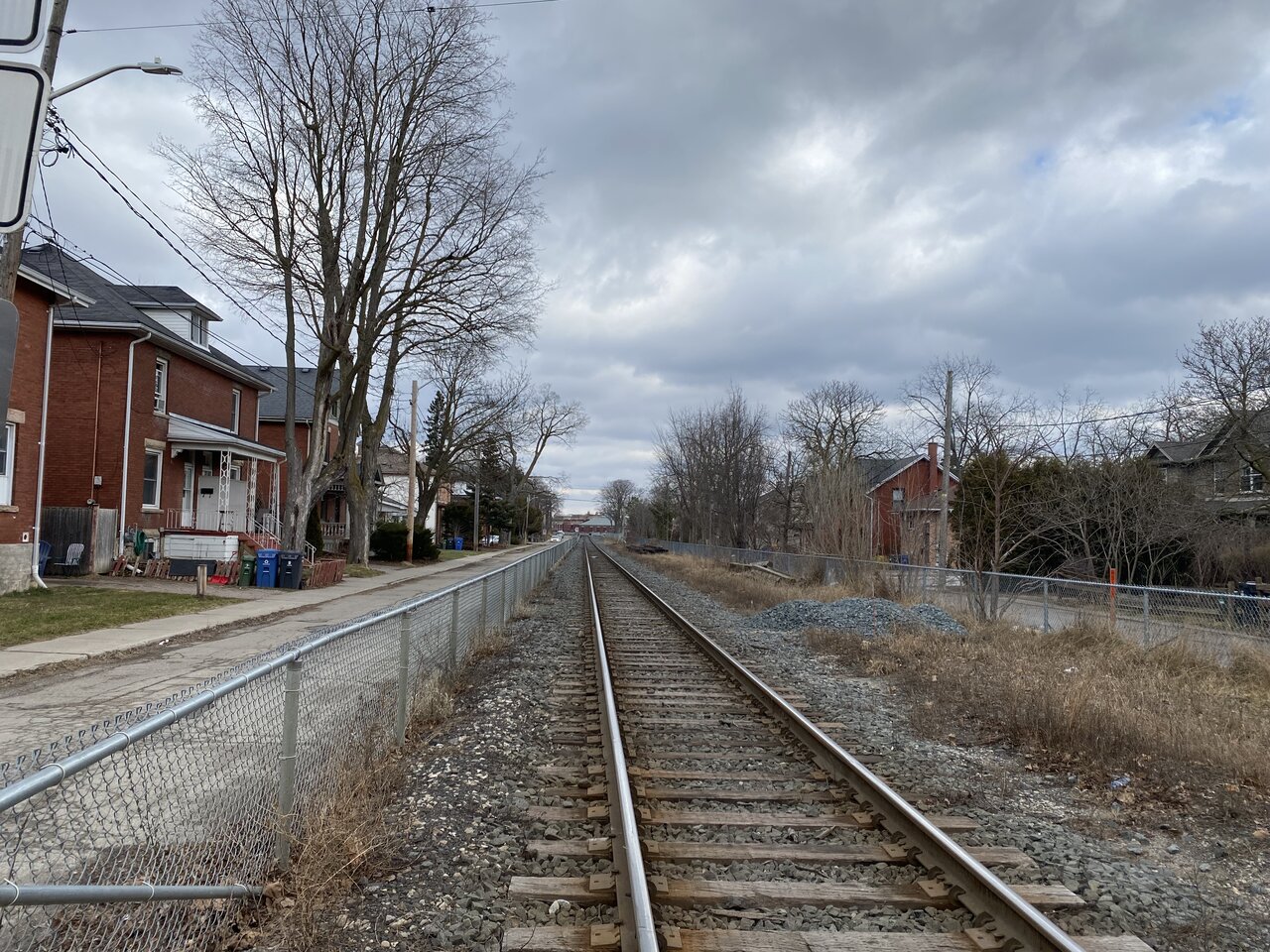

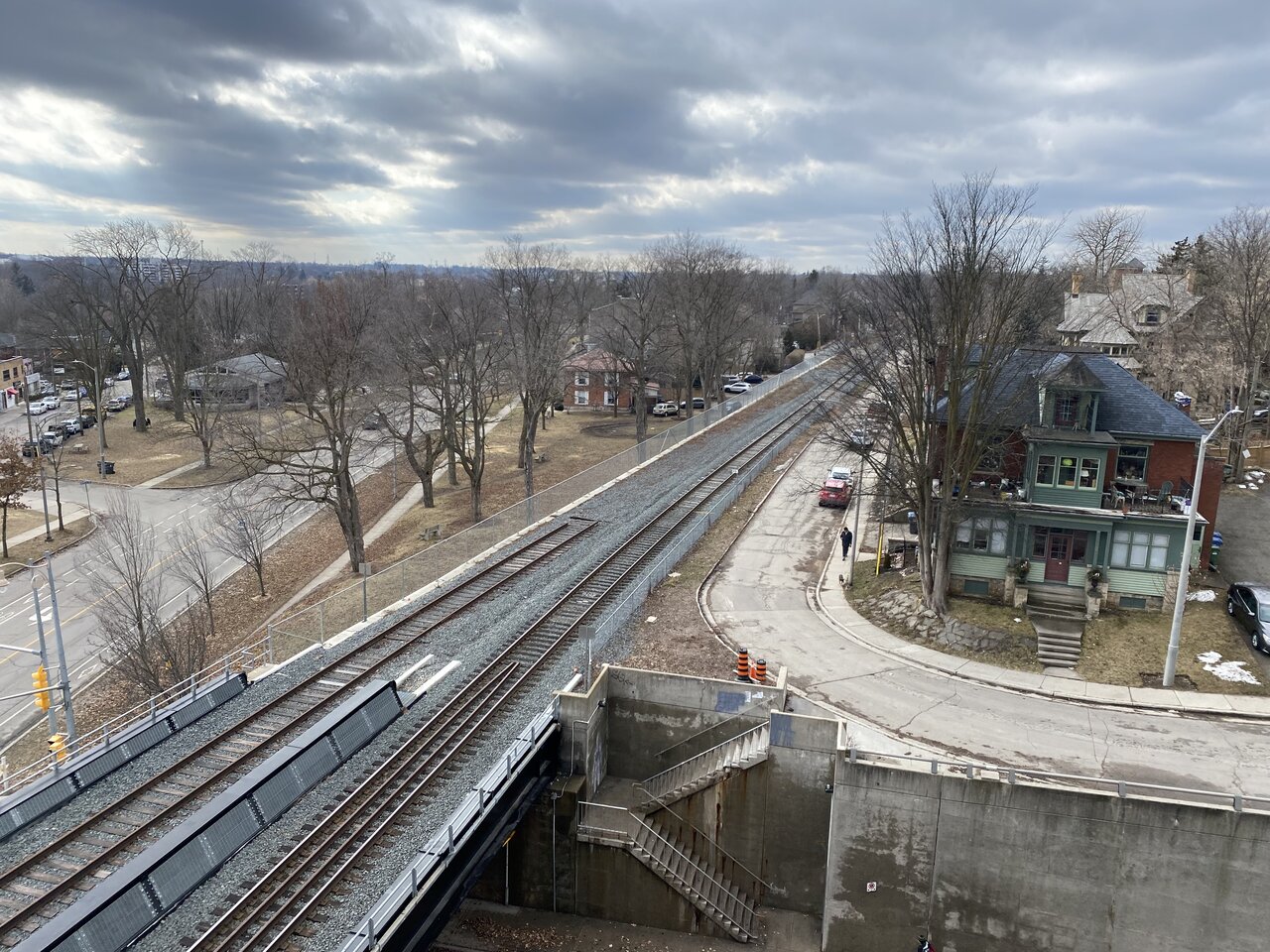

Speaking of Guelph Sub. I walked along the subdivision west of Guelph Central Station today. The 2nd track is in only over the bridges spanning Wilson & Norfolk. Would be nice to see the 2nd track go in soon.
You can also see the end of the new south platform.
Moving from East to West ending at the Glasglow Street crossing.
If ML had to lay even a single crosstie before each self-congratulatory press offering or tweet.....
Okay, I'm exaggerating slightly.... but seriously..... I know railway museum volunteers who could close those track gaps in a single weekend of track laying.

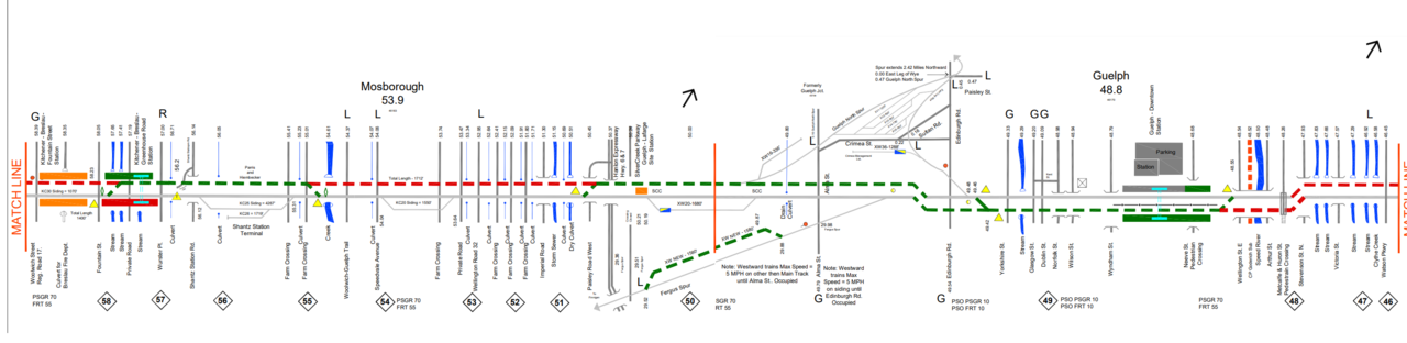

Maybe this is what Packages 1 and 4 will do per @SaugeenJunction 's RFI post above? Connect this track/add more?
Possibly, but it's very small potatoes to need an RFI to lay that much track. (Which is likely why it is waiting until the very end of the platform construction - pretty much a "finishing touch").
When I last heard, however, the end state track configuration at Hanlon was still under discussion in light of input from CN and G&W. That might cause further design work and rewiring of the CTC interlocking.
