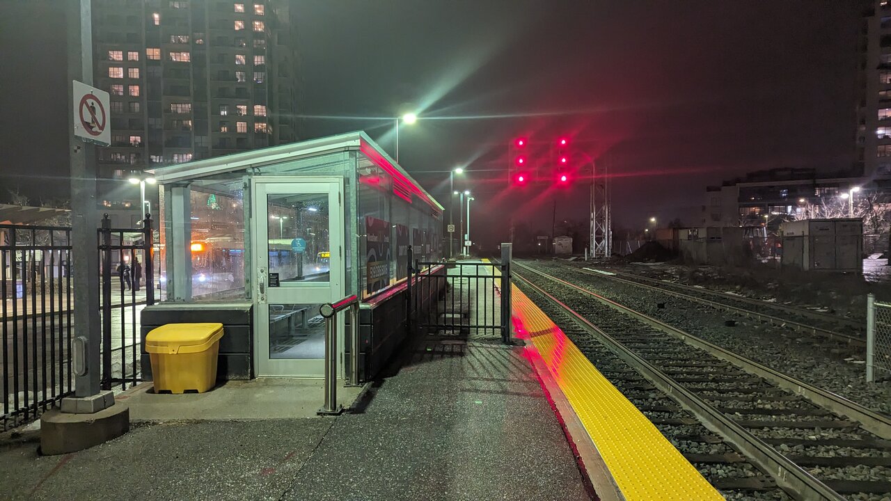

That reminds me, I was at Guelph Central two nights ago, and they put this gate in at the east end of the existing platform, which I found curious. It wasn't locked. Any insights?

They've shifted the stopping position of the trains west along the north platform. The gate will be accompanied by signage indicating as much.

The stopping position was moved west to enable operators to see the new signals at the Conti control point visible in the image.

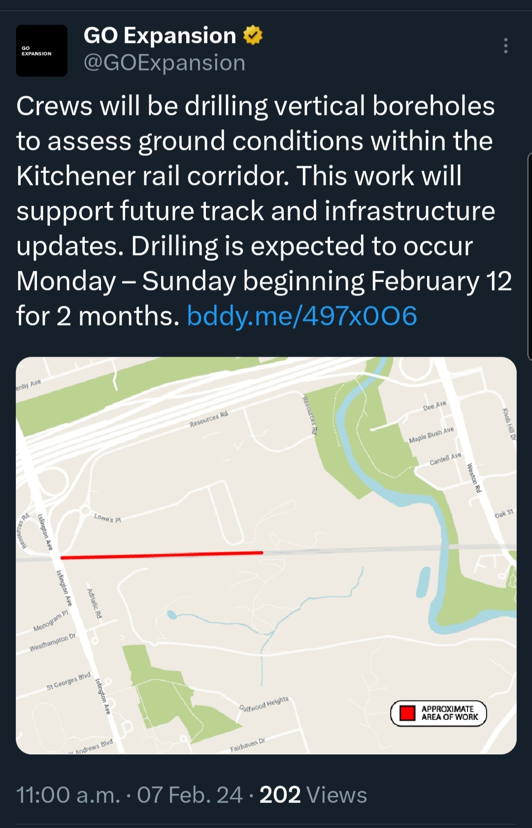

Always interesting to see where this kind of work is taking place (and new location) as part of the expansion/track capacity work. This is near the 409/401 new tunnels. cc @crs1026
Not sure why they are going that far east as the 4-track interlock block is a short distance to the east of Islington with all four tracks in place with block working signals. There is enough room from the interlock to Islington to spread the tracks apart for two tracks to use the two tunnels and two of the three tracks currently under Islington Overpass. Since you already had three tracks under Islington, I found it odd that they need to build two extra tracks under the 401/409 unless they were looking at having five tracks at this point to the airport cut off with two being used for UPX only.
The existing tunnel has a speed restriction due to low clearance. Reducing it to 2 tracks will eliminate the speed restriction.
There is not enough space for 4 tracks under Islington with the existing grading. They need to build a retaining wall on the south side of the underpass to fit the south track under the existing structure.
