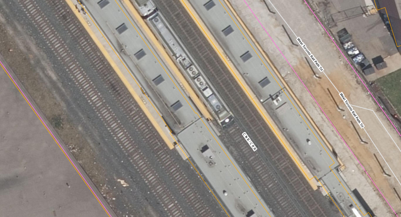

I think your rendering is clear enough that a track goes on the east side......... but I do want to show you what I was looking at, misleading as it is, obviously.
Pink Lines are property lines.
Its important to note here that at various points along the station, the measure from various property lines to other points such as the rail path or adjacent buildings varies. I can't illustrate them all, but I'll show a couple again, just so you can see what I was seeing:
West side:
That blue line above is 7.8M in length
Just piping up to highlight that there may be an optical illusion at play. The roof is likely overhanging the property line because the satellite took an off nadir angle.
