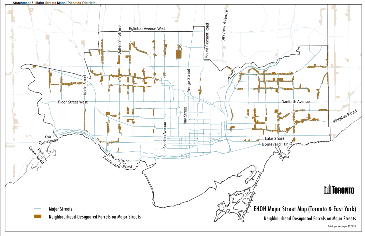

The highlighted area reflects portions of Major streets currently designated 'Neighbourhoods'

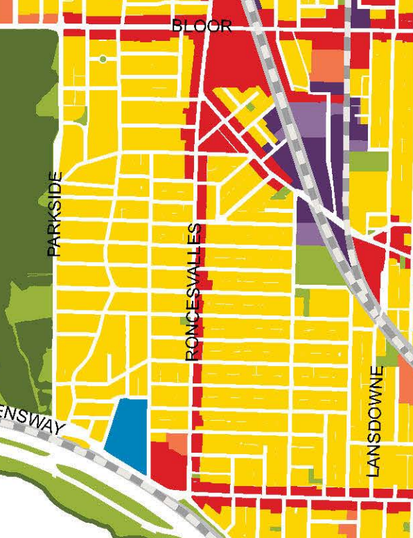

Can anyone explain why the west side of Roncesvalles isn't highlighted? It is for sure "neighbourhoods" in the official plan:
Is it because Roncesvalles is considered an Avenue? And if so, does that mean that six-storey apartment buildings already permitted as-of-right on the west side?

As the provided maps illustrate, this change covers a relatively widespread niche of SFHs along arterials. It might not be perfect, but this grabs a fairly low-hanging fruit in the built environment to change. These types of sites wouldn’t see the pressure to develop more intensely that would have been necessary prior. I really wish we could see this in Hamilton, where like Scarborough and Etobicoke, the arterials are compact, leaving lots of major streets where SFHs aren’t appropriate but aren’t really conducive for bigger projects.
I agree that it isn’t a golden goose, but this feels directed at the “forgotten” places where their stasis is most obviously unecessary. I always thought living right on an arterial like such in a detached would be undesirable anyway. Busy street but none of the livelihood to compensate. Hopefully townhome assemblies become prolific soon.
We really should be working to eliminate driveways on arterials as well. Direct access off arterials impairs throughput through turning movements, and increases conflict points for pedestrians and cyclists. It is crazy to see lots of SFHs with driveways off of fast-moving arterials.
One way to do this is to create frontage/access streets flanking the arterial that can do double-duty of providing low-speed access to adjacent properties while providing a cycle path/parking off the arterial. Bonus points if you can reduce the arterial prtion of the ROW to one lane per direction for traffic calming (no passing).

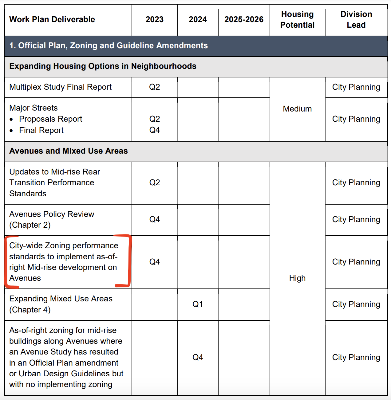

OK, I think I've answered my own question. It sounds like a report on as-of-right midrise zoning on Avenues is coming soon: https://www.toronto.ca/legdocs/mmis/2023/ex/bgrd/backgroundfile-234817.pdf
I do find it a little strange that the city is contemplating as-of-right midrise zoning on non-Avenue major streets first. The Avenues feel like an obvious starting point and I wonder why the city isn't doing them first.
Striking while the iron is hot? Perhaps it is precisely because rezoning the avenues is such a imperceptible change that they are pursuing the “big things” to get them out of the way. These changes are all coming back to back, after all. Has Toronto ever modified its zoning so rapidly in such a short timeframe?
