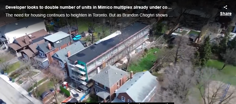

Etobicoke residents accuse developer of ‘gaming the system’ in fight over controversial eightplex​
The building, located at 63 Station Rd. near Royal York Road and Mimico GO, was approved as a fourplex, but the applicant is now asking the City of Toronto’s Committee of Adjustment to permit eight units, arguing the change requires no major structural alterations.
They're not wrong, in this case. Look at the size of this:
No way that was ever envisioned by the builder as a four plex, I'm not buying.,
May I add, I don't see how it got approval in the first place, the lot coverage is unacceptably high, the standard is simple, if everyone built that way on this street it would be an environmental disaster. There's no ability to absorb rain fall, forcing it all into the sewer system causing overflows of raw sewage, additionally, there's no trees except in the front, which means significant warming effects.
This is why not all Nimybism is wrong. I take no issue w/height, or tenure, but the building' depth should be cut in 1/2.
Nothing wrong with a 4-plex here; something wrong with an 8 plex that is terrible for the environment somehow obtaining approval under pretense of a 4-plex, at a lot coverage that would not normally pass muster.

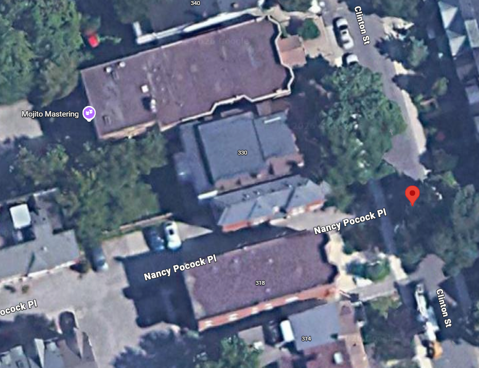

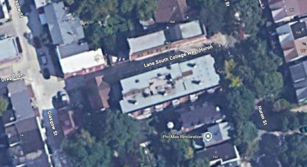

While it looks out of place here, there are examples of old apartment buildings with similar profiles in Toronto. Here is one on Huron and 3 on Clinton. @Northern Light Could this particular building work better with some tweaks like rainwater capture, green roof?
