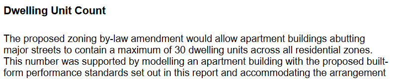

This is the key bit:
Six storeys as-of-right is actually more than I was expecting; I wonder if Planning did that so that the compromise on the floor of Council will still be 5.
The 30-unit limit seems odd to me.
If I had a choice, I'd rather lose a floor and pick up as-of-right permission for 60 units.

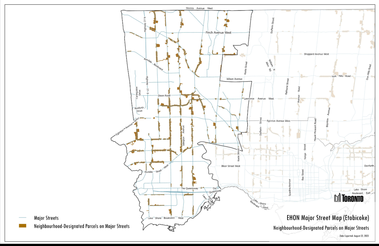

The highlighted area reflects portions of Major streets currently designated 'Neighbourhoods'
Maps link: https://www.toronto.ca/legdocs/mmis/2023/ph/bgrd/backgroundfile-239321.pdf

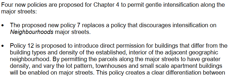

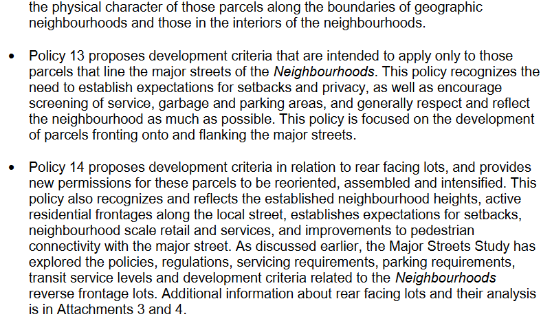

Back to this between slurps of lunch-time soup.
The main detailed report is here:
From the above:

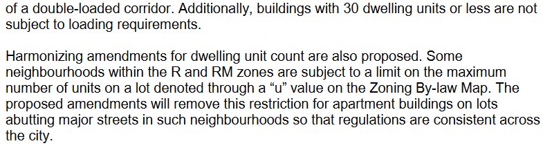

Here's the rationale on the unit count:
Not sure I agree on the above.; I see the loading requirement is identified as an issue; but I'm inclined to think about elevators being amortized over only 30 units. Hmmm

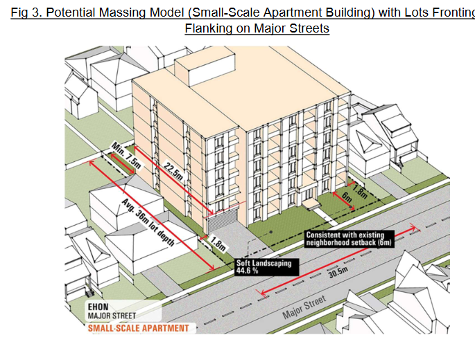

@ADRM 's favourite unit in City Planning; Urban Design got their teeth into this too.
They did conceptual modelling.
That can be found here:
Comments, overall, very much the right direction, in the above images, the setback from the sidewalk is gratuitous, Even if you wanted 6M in every case, for argument's sake, I'd much rather have a 2-3M blvd that can support trees, and buffer pedestrians from traffic and then a smaller area in front of any building w/o retail that afforded room for some landscaping.
That said, the 6M doesn't make universal sense; I'm not clear if its the intent to require this across the board, or in areas where this is the current norm.

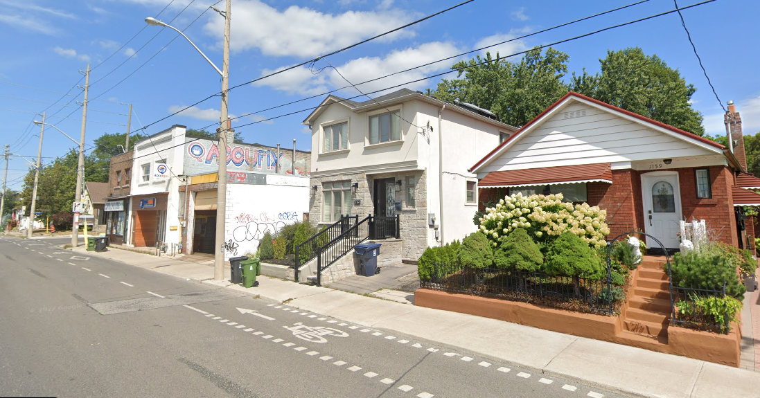

Example: Woodbine Avenue:
Even in more suburban locales, I'm concerned that a deep set back like this precludes adding additional retail areas; and stifles the 15-minute city idea.
I'm open to setbacks like this if there's a clear understanding that retail is not viable and will not be in the foreseeable future on a stretch of road; but lets not start from the premise that we're insisting on all residential ground floors.
It affects fewer places than I would have expected.
The maps are not what what is being upzoned, the maps are what was yellowbelt.
To my understanding, the proposal is for as-of-right on every major road.
Oh - my bad, absolutely right: they’re highlighting the parcels in Neighborhoods that would now benefit from this new “as-of-right” zoning.
I’m really puzzled by the unit cap. I read through the rationale, and was not particularly swayed. I’m fine with 6 storeys, and hope that doesn’t get chopped. All in all, the unit cap and setbacks are my biggest objections here. Kudos to TO Planning for continuing to push intensification.

The only rationale I saw for the unit cap was that over 30 units you have to have a loading zone.
To my way of thinking:
1) That's a builders call, if they can't deliver one with what is otherwise permitted, then they won't build over 30 units, let them figure that out.
2) At six storeys you face certain costs around elevators, among other things, that you would not at 3s or less. The ability to amortize those costs over more units is material.
Agreed.
In general, I think the fewer constraints we put in, the better, because it gives the proponent the flexibility to decide what they want to push for and deal with. If they want a loading zone/elevator and believe they can amortize the costs over the units and that the market will pay for it - go for it.
