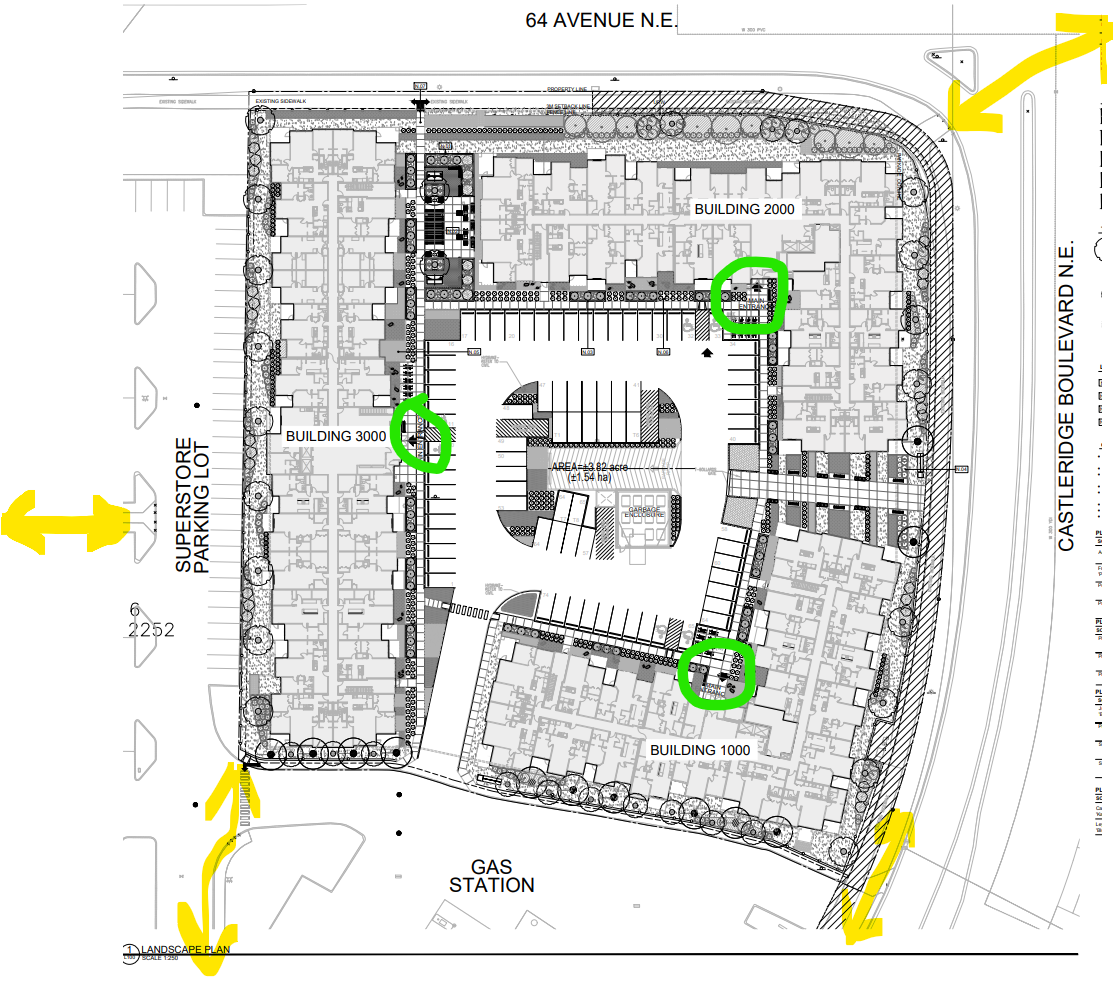

Design is pretty abysmal to be honest. I don't care about cheap materials - which are inevitable - but a complete disdain for how the future residents will be able to connect to where they want to go in any semblance of a direct or quality walking connection is impressive here. Another example of where it's not entirely the development's fault, but they certainly aren't bringing much to the table to help.
It's the type of development that helps the city overall stats only because it's not built in the literal middle of nowhere like some fringe developments. But that's about all it does that's positive. I am usually pretty pro-density and forgiving to design quirks but this one really doesn't make sense and is a net loss.
Same here. I care less about the building and it's design than I do about the overall setup. The buildings themselves aren't actually much different than say, Catalyst or WestUrban37, but those buildings are improving the urban fabric of the city, and can be a positive place for people to live.
For this one, the location is a challenge to start with thanks to the way the area is designed, but as you've pointed out the general design is making it even worse. Density gone bad.
Issues:
  • No route is direct between any building entrance and and the surroundings you might want to go to.
  • Building orientations block all direct routes from the intersection, while also cutting off the direct parking lot pathway to superstore. In this way not only does it make it inefficient for future residents to access grocery and transit, it also makes it less efficient for every person in the surround neighbourhoods too that lose a direct pathway.
  • Inward focused parking courtyard and outward facing arterial roads means constant traffic noise and circulation at all times, on all sides. All sidewalks within the site are 1.5m only. Surface parking everywhere, on and off the site.
Given the level of design at work here, they probably couldn't have made a bigger traffic generator if they tried. It's car-oriented, awkwardly dense, huge amount of parking, contributes to a largely anti-pedestrian context minus a grocery store and LRT at a hefty distance away.
I completely agree. I've lived the majority of my life around this area and have seen it get worse, as the population has boomed. It is frustrating that they've never considered adding an entrance/exit along the 64 ave side. Just adding the exit and mini ramp along those areas would drastically change the area from the vehicle sewer fest it is right now.
