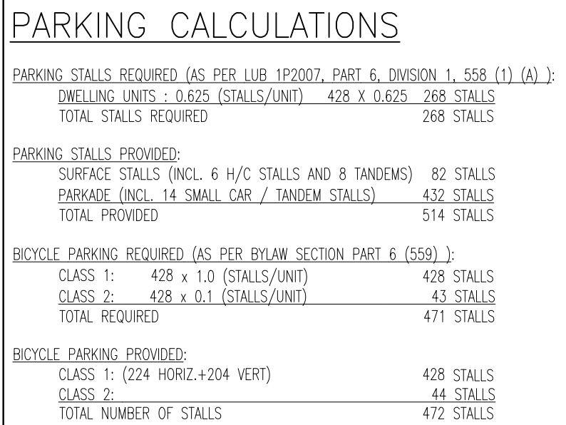

Perhaps unrelated:
I suspect the only reason the bike stalls exceed the requirement is they haven't figured out how to make a rack with only one side.

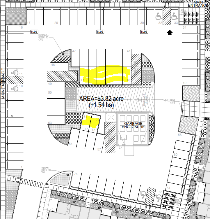

Speaking of parking:
Are tandem stalls like this (at grade, presumably for visitors) a common practice?
Not that I'm upset about a few hundred more units within walking-ish distance of transit... maybe not transit oriented development or even the local special of transit proximate development, but transit proximate-ish?

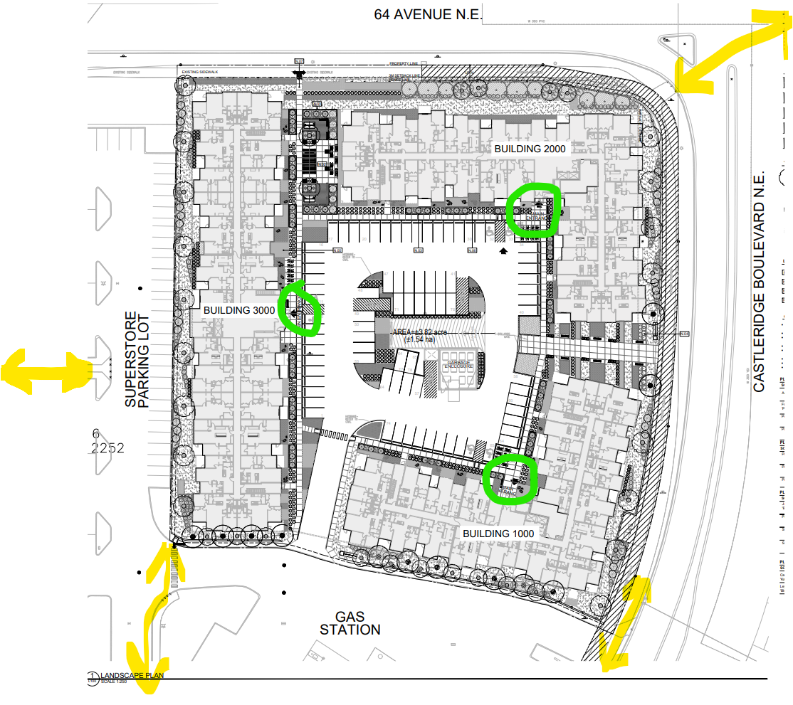

Design is pretty abysmal to be honest. I don't care about cheap materials - which are inevitable - but a complete disdain for how the future residents will be able to connect to where they want to go in any semblance of a direct or quality walking connection is impressive here. Another example of where it's not entirely the development's fault, but they certainly aren't bringing much to the table to help.
Issues:
  • No route is direct between any building entrance and and the surroundings you might want to go to.
  • Building orientations block all direct routes from the intersection, while also cutting off the direct parking lot pathway to superstore. In this way not only does it make it inefficient for future residents to access grocery and transit, it also makes it less efficient for every person in the surround neighbourhoods too that lose a direct pathway.
  • Inward focused parking courtyard and outward facing arterial roads means constant traffic noise and circulation at all times, on all sides. All sidewalks within the site are 1.5m only. Surface parking everywhere, on and off the site.
