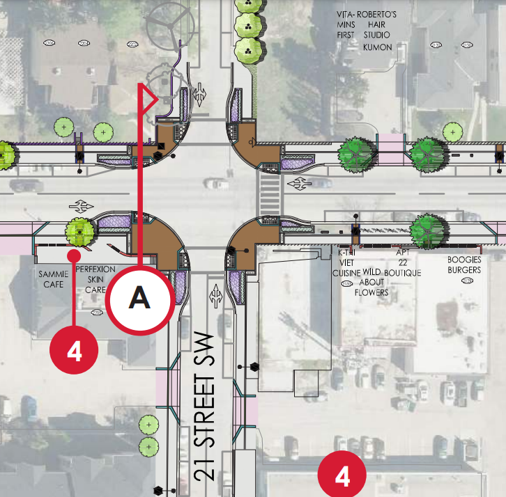

The SW corner of that intersection appears to have a big bump out

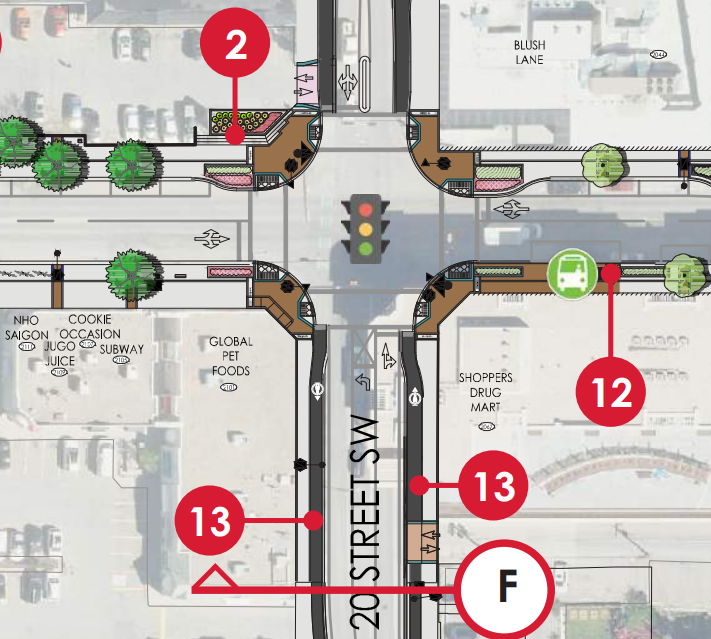

That's not the intersection we're discussing. This picture you posted is 33 and 21.
We're discussing 33 and 20. Although it looks like one lane, people will likely be passing the bus on the right as it's stopped at the location just east of 20 (you can see a square on the drawing for the bus zone). You can also see the EB lane on 33 is a triple-action lane and will be wide enough for people wanting to go straight while someone is going left to do so.

That looks like 21 St. I was referring to 20 St.
Again, I expect that the curb extension on the SW corner of 33 Ave and 20 St is less pronounced because the need for a wider turning radius. I don’t think there is a bus route that turns right at this intersection, but maybe in the future, and 20 St might be important for deliveries in the area.
EB 33 Ave at 22 St also does not have a curb extension (and actually maintains a right turning lane) which makes sense for deliveries to the Safeway and other businesses in that area, and keeps traffic moving off of Crowchild.

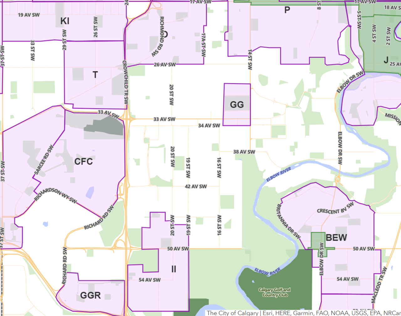

But to keep this reasonable concise let's just take these criteria at face value and look at the locations boundaries of existing permit areas. The map below is of residential permit zones in the inner SW. Note the absence of Marda Loop in here, but there's far more weirdness going on than that. I didn't bother posting the paid on-street map because it's only visible for a sliver of Mission and 17th Ave near the core.
Some examples that make zero sense given the same criteria:
  • Area 0 (Richmond Hill near the old Children's Hospital) - zone was established due to Childrens Hospital demand. They moved over a decade ago and the services in that building are a fraction of what happened before. No way they pass the "major trip generator" test. Streets are always empty and area is largely expensive SFH infills.
  • Area P (Upper Mount Royal) - sure, there's probably a sliver of the community near Western Canada High and Lower Mount Royal that if you squint meets the threshold of demand in the criteria. Why then does the permit area extended 15 blocks to the south? There is no trip generators, no demand - yet a parking permit area exists. Taking a guess here that being a wealthy enclave seems to influence the size, shape and existence of a parking zone or not (or traffic calming in Mount Royal's case).
  • Area GG (South Calgary Park) - in what world has that park ever generated traffic to the level that it meets the criteria? Do the occasion children's soccer tournament count as a major trip generator? If so, give the whole city a parking permit boundary.
  • Area T (Richmond, west of Crowchild) - no clue how this qualifies, again it's the lowest density area of Richmond. No trip generators at all. Maybe that old Vicount Bennett school site was enough at one time to trigger a boundary being created? That school has sat empty for at least a decade I think.
  • Area CFC (Currie) - my favourite example. CFC - Canadian Forces Calgary perhaps? Do we really have a parking boundary for a military base that was decommissioned 25 years ago? Where's the trip generator? Almost everything built in Currie thus far has dual garages off the alley.
  • Area BEW (Brittania/Elboya) - Get real. What is the trip generator here? Britannia Plaza doesn't create spillover parking anywhere close to this scale.
In conclusion, the Residential Permit system is indefensible pseudo-science not fit for purpose at best, total regulatory capture at worst. Probably a bit of both. Most critically and ironically it isn't actually a tool for management of parking supply and demand:
  • Entirely complaint based and dependent on community approval, it's not proactive supply/demand monitoring triggered.
  • It relies on an assumption that residents have ownership of the public street over others.
  • It is inflexible and rarely is updated when context changes - hospital closes, school closes, and the original justification doesn't materialize
  • Boundary conditions are arbitrary and seem pretty likely to be influenced by politics, favouring abuse by communities that have the aptitude, wealth and negotiation ability to create an outcome that is more restrictive than something more based on trying to actually manage parking supply and demand.
So Marda Loop could probably qualify for this program if they could get it together and align their community messaging. But that would do nothing to manage parking issues in the area. Paid parking is the solution here, combined with shifting demand via more intensity within walkable distances, mixed uses and better transit, walking, cycling options.

I think we’re saying the same thing re: the arbitrariness of the RPZs.
My point is that there are areas within and neighbouring the Marda Loop BIA which make more sense to be RPZs than other areas that have been established as RPZs (GG as an example), but don’t meet the arbitrary criteria to establish them (e.g., a hospital).
I also agree with you about establishing paid parking, but would point out that in an area like Marda Loop (33/34 Aves specifically), the recent changes made to the RPP program actually makes an RPZ “paid parking”, because residents of buildings of 4+ stories or with more than 20 units requires a Market Permit (in GG, the 2023 cost of a Market Permit is $100/month ($1,200/year)). These streets (33 in particular) are transitioning to these types of buildings.
