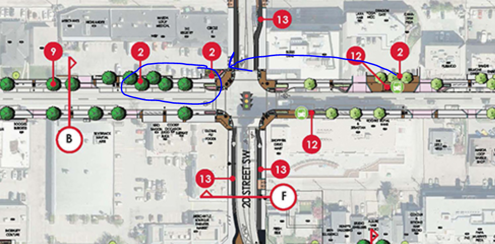

I didn't explain this well. The part they should be bumping out is circled in red here, which is in front of the Shoppers building. If this concept is accurate, this design creates a merging conflict for both Route 7 and 22 east bound so both buses would be regularly delayed by the stream of EB vehicles. The WB stop discussed above won't have this issue as cars would wait for the bus:

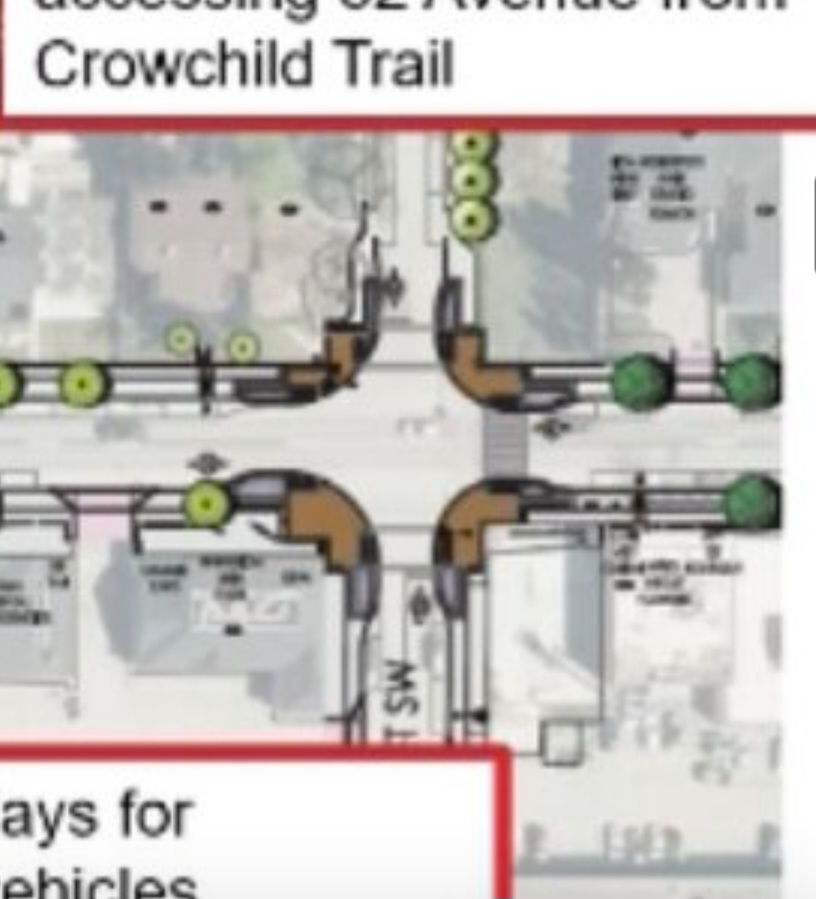

I wondered the same thing. There isn’t much of a curb extension on the SW corner either, so we’re likely to continue to have eastbound drivers going around vehicles turning left at this intersection.
I think the lack of curb extension on the SE corner likely has to do with the right hand turning radius of buses (i.e., the 7). They’d likely have to move the bus stop further east if they wanted a curb extension, at the expense of parking (which is fine by me but not acceptable to many).
The SW corner of that intersection appears to have a big bump out

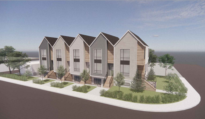

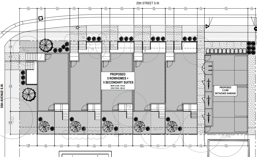

People are losing their minds about a 5 unit townhome each with their own basement nanny/in-laws/student suite. It's proposed for 20th St and 50th Ave. Having 10 units on a corner lot with no street parking because of the odd intersection layout and cycle track/bus stop on 20th, is pushing people to their limits. How many of those 5 basement units will have a car is hard to predict. If each unit has one car that's 10 cars looking for parking, 5 can go in the garages, leaving 5 looking for street parking that's either on 50th or 49th. Not accounting for people visiting the people in those units or any of those units having a second car. People make these arguments and get traction because, like you say, people think they're entitled to use the street as their private parking space. They're not. I've commented on the application, in defense of it. I hope if you're in favour of density and not worried about having to walk 50ft to get to your parked car you too will also comment. Can't have all the comments be negative.
