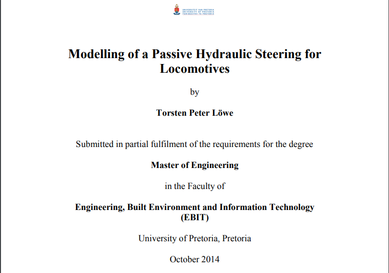

lol...keep it coming:
180845
https://www.mobt3ath.com/uplode/book/book-41708.pdf
Probably a bit steep for some. At least it's in English, might give some half a chance...well, maybe not. Some would claim the Earth is flat and think it clever to state so.
The principle used in the Transtech bogie is completely demonstrated and analysed. And it even has pictures for those that can't read.
