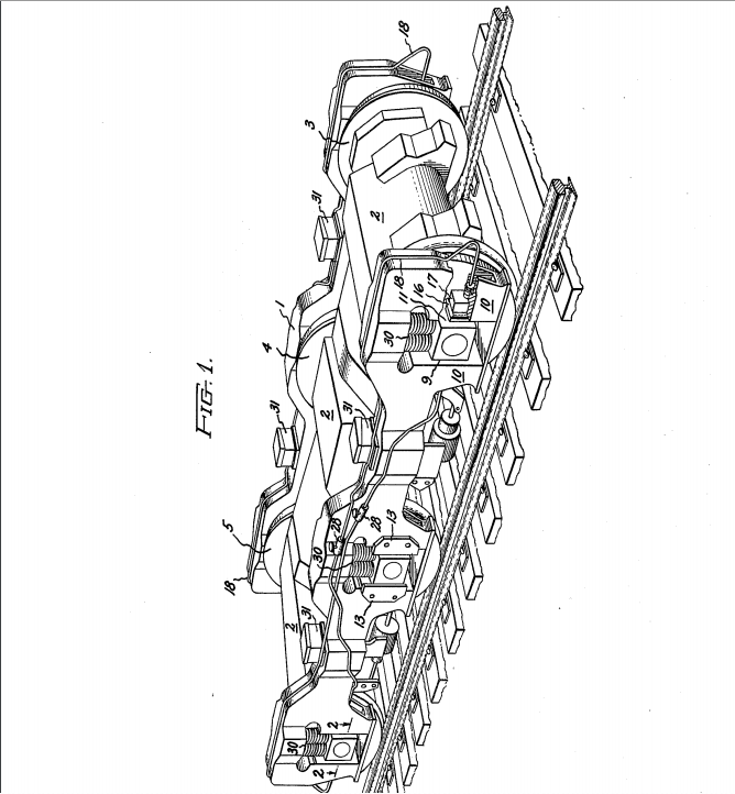

I see. You know of only one method, and hold the rest of the world to your limited understanding. I'd have some sympathy for your understanding only North Am methods, save that GE (I presume you're familiar with them?) have this patented method.
I challenge you to indicate where "There needs to be a linkage between the axle ends of each truck, and the truck itself. These have none of that." are on this design:
http://www.freepatentsonline.com/4440094.pdf
Lots more detail exquisitely supplied at that link. Allow me to offer your next excuse: "Oh, but that's for a three axle bogie". There are separate patents for a two axle one.
Readers might find this interesting: http://www.freepatentsonline.com/4285280.pdf Developed in Kingston and assigned to UTDC, albeit it's a simple mechanical actuation, somewhat as Smallspy describes.
