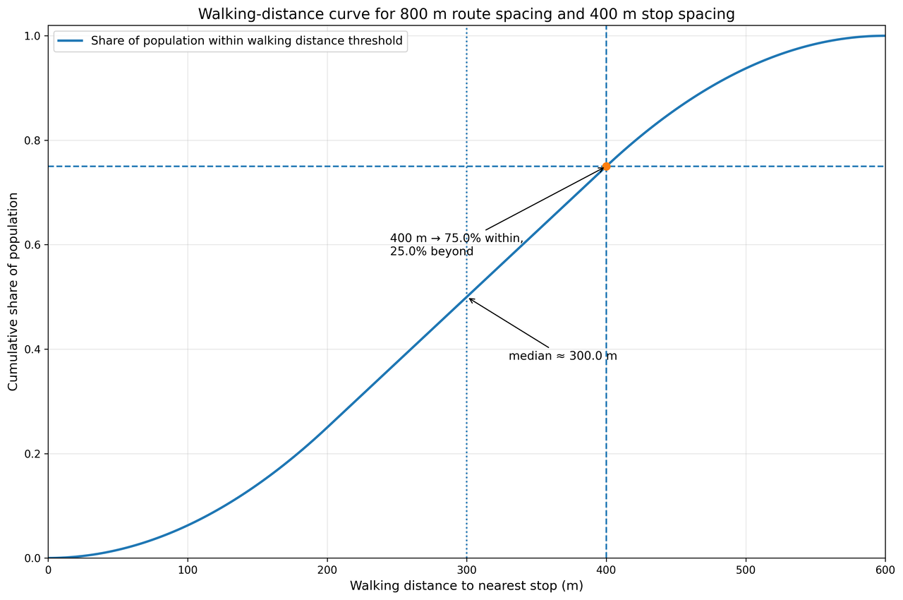

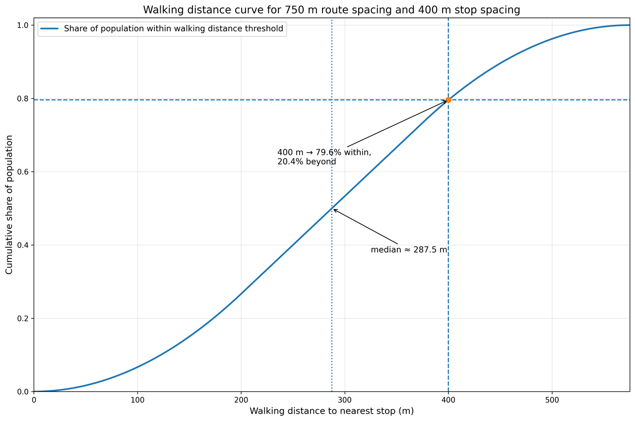

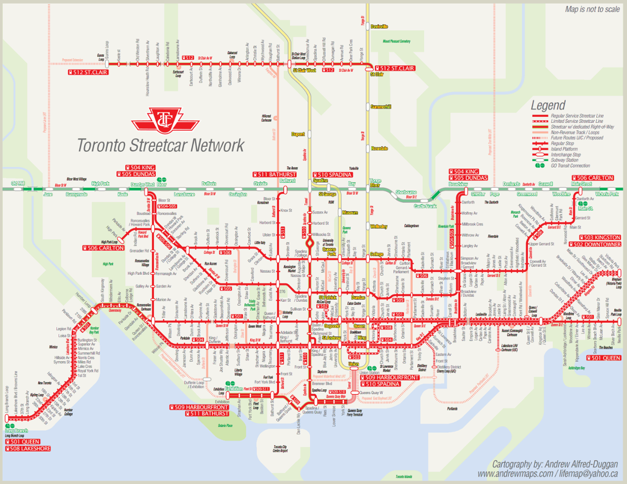

I'll also add, the TTC streetcar network is already very dense. 83 km of streetcar in a much smaller area vs. 70 km of subway. From Bloor to Front is less than 3 km North-South. It would not surprise me if 1 million people live within 500 metres of a subway or streetcar stop (and most still would if almost 50% of the streetcar stops were removed).
Chengdu, China for reference: "As of 2021, about 2.2 million and 4.6 million people live within 500 and 800 metres (1,640 and 2,625 ft) of a subway station in Chengdu, respectively." (Wikipedia) Counting interchange stations once, Chengdu Metro averages ~1.99 km stop spacing as of 2025.
If you remove the middle stop of those three, you'll not only see that the area covered by the circles is far smaller, but also the distance covered away from the street that the transit is traveling on is far lower. People are not willing to walk 20 minutes just to get to a bus stop.
King to Queen (~350 m), Queen to Dundas (~450 m), Dundas to College (~600 m), Bathurst to Spadina (~600 m) are so close together, their 400 metre circles are all overlapping. Even if we go off what Steve is saying, we could easily have stops be spaced 400+ metres apart and still have overlapping circles covering most of Downtown. (See charts below).
The adjacent streetcar lines (and their streets) would have to be much farther apart before the walk is consistently more than 400 metres long. And again, a 400 metre walk is ~5 minutes for most people. I would argue a 10 minute walk is the hard limit for rapid transit.

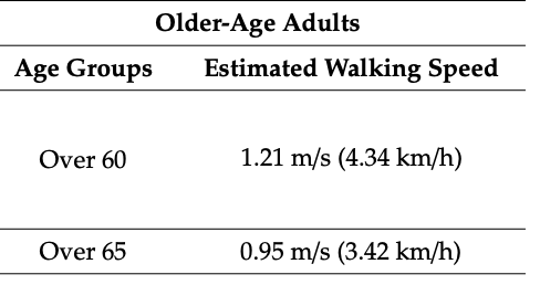

https://www.medicalnewstoday.com/articles/average-walking-speed#average-speed-by-age
The problem is Canadian culture being against active transportation.
Canadians don't like walking or biking. The reason why Chinese stations are spaced so far apart [2 km], even in densely populated areas, is because originally you were expected to walk, bike, or take the bus to the station. Over time, as the networks themselves grew (and effectively densified), the average distance to the closest station shrank. [See Chengdu]
For the area between two streetcar lines, assuming regular/unstaggered stop spacing, and uniform population distribution (in reality, people are more likely to live on larger streets, which would lower walking distances):

The charts show, if stop spacing is an even 400 m, for most of Old Toronto south of Bloor, it's a ≤400 m walk for upwards of 75% of people (800 m route spacing, 400 m stop spacing). For most of Downtown south of Bloor, it's a ≤400 m walk for upwards of 91.7% of people (600 m route spacing, 400 m stop spacing).

Here is what 600 m route spacing and 500 m stop spacing looks like (between Dundas & College at the widest points, and Bathurst & Spadina).
Median 275 metres is 3'48" at 4.34 km/h, or 4'49" at 3.42 km/h.
Call it 4+ and 5+ minutes to account for red lights and stop signs.
98.3 percentile 500 metres is 6'55" at 4.34 km/h, or 8'46" at 3.42 km/h.
Call it ~8 and ~10 minutes to account for red lights and stop signs.
Is it that big of a deal that roughly 1/6th of people have to walk more than 5-ish minutes (400 metres @ 40 year old/median age speed) to the streetcar stop? Virtually everyone at every age is within 10 minutes of a stop (500 metres).
350 m stop spacing is more realistic for this wave of improvements:
94.6 percentile 400 metres is 5'32" at 4.34 km/h, or 7'01" at 3.42 km/h
20-30 minutes of aerobics is recommended for seniors. Worst worst case, is walking 20 to 40 minutes for a round trip that big of a deal? 10 minutes from home to the initial stop, another 10 minutes after arriving at the destination stop to get to your destination, 10 minutes back to the destination stop, 10 minutes from the initial stop to home. Use it or lose it.
